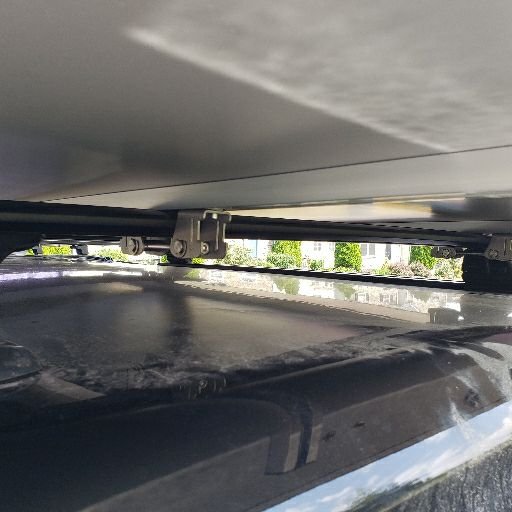

I mounted it on Thule bars, with Thule special made bolt for the high load like it uses for the construction companies to hold heavy load. So far it was all good even some off road trail.
