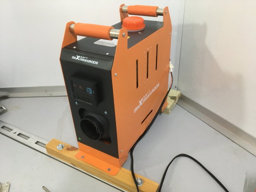

got this 5kw off amazon and I ended up using a dedicated 35ah battery and it ran several nights without recharge. I don't have a numerical amount to give, but they don't use much power. I set the fan fairly low and it really just sips the power...I'd guess this one is about 1.5 to 2 amps per hour on 12v battery.

Thats a decent amount of run time grubworm thanks for the input...
