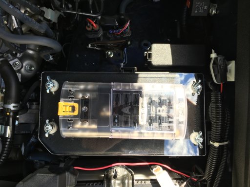

Ran mine to a blue sea aux fuse block I installed. Obviously not hooked up here. This is after I did the install. I have found this to be a great way to help keep things clean and orderly as I added accessories/lights etc.
