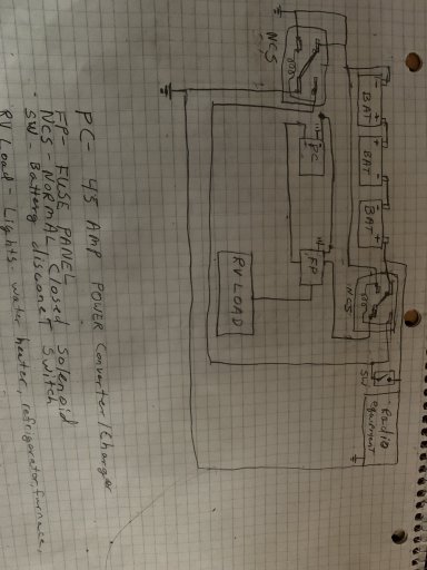

Unfortunately all of our solenoids are normally open. If you could draw out a diagram of your system, my in house guru said he would be happy to go over some alternatives for you that we may have to offer? Let me know, I can set something up.

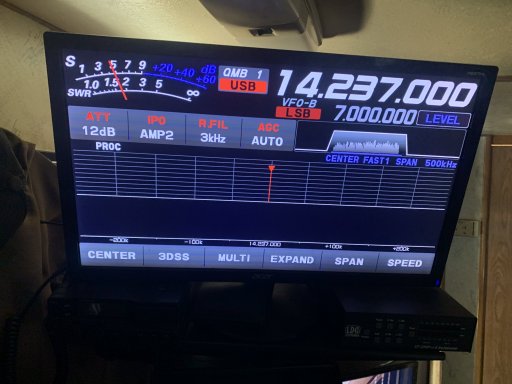

All of the white spikes in the second picture is the DC Power converter and RV load when my house batteries are connected to my Power Converter and RV Load.
When I isolate the batteries from the RV Load and the Power Converter I get picture 3. As you can see the DC voltage spikes disappear.
Since my radio equipment is only used a couple of hours per day, but the rest of my RV Load is needed 24/7 I need a way to disconnect the batteries for a short period of time. I am afraid that using a normally open solenoid will generate too much heat if the circuit is closed for 22 hours per day 7 days a week, 52 weeks a year.
Another solution I have would be to buy a different power converter which would eliminate all the noise, but the power converter I need is around $200 where I’m hoping to find a solenoid for under $50.00. Another solution would be to buy a 12v power supply, but then I’m using AC voltage to get DC voltage I already have access to, and the price is the same as a Power Converter
Last solution is I keep doing what I have been doing and go outside and disconnect the batteries from the RV Load every time I want to use the radio, then rehook the batteries to the RV load when I’m done using the radio. This just becomes a pain because I use the radio mostly at night and playing with batteries in the dark is not fun.

I’ve finally found my solution. I need to make a “Flip-Flop” Latching relay circuit, I’m still looking at what relays I need to use. But should be starting this project soon. I’m tired of my radio battery during on me or forgetting to unplug the battery from the house when I’m operating… having the controls inside my shack will make life so much better.
