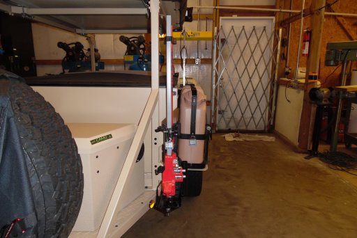

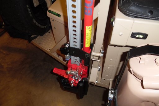

I used a high quality cable lock system, fed thru the base plate, jack head, beam and mount. By securing it this way no one could unbolt the base and slide off the head assembly. Ron

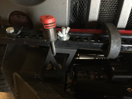

I just use a couple pipe clamps with a bolt welded to them. The Standard is sandwiched between some old poly shock bushings to keep the rattling at a minimum. In the driver side door pocket, there is a small bag of tools that see the most use. That includes a 3/4" wrench to get the nuts off for the Hi-Lift. Aside from the large size of the official Hi-Lift clamps, they are just turn knobs, so anyone can have quick access. The nuts are a little more of a determent, but as usual, if someone wants some bad enough, they'll find a way to get it.
The issue I have with padlocks that sit outside is, over time they just get grime and water in them and can become difficult to unlock when you need them. I have 4 small Master locks to secure the Maxtrax (way more expensive to replace those than the Hi-Lift) on the roof rack. Two of them open and close just fine. Of the other two, one took 10 minutes of jiggling with the key to open, the other isn't unlocking at all. We just had a day of light rain yesterday, so today I'm going to squirt silicone spray in all of them, and hope that last one frees up.

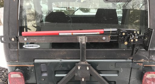

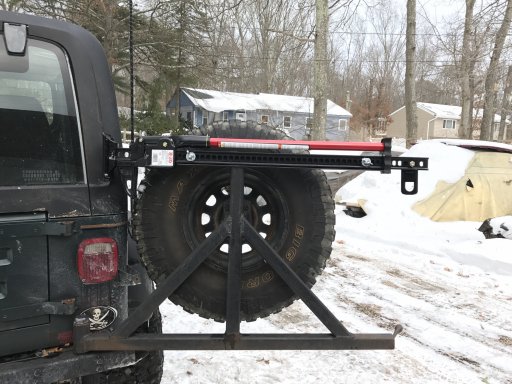

Got a chance to fab up my Hi-Lift mount since posting this. This is what i decided to go with, now i just probably plan on drilling a hole through the bracket and attaching a bike lock or some type of cable lock.IMG_1069.jpg IMG_1067.jpg

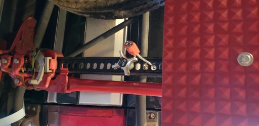

I made a security rope from 3 feet of 1/4" , plastic sleeved steel cable, crimping sleeves and a small padlock. The cable loops through the tire carrier.
It's basically good for preventing an opportunistic grab and run situation. Won't stop bolt cutters
