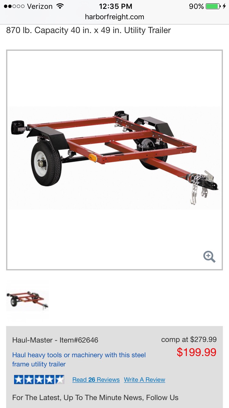

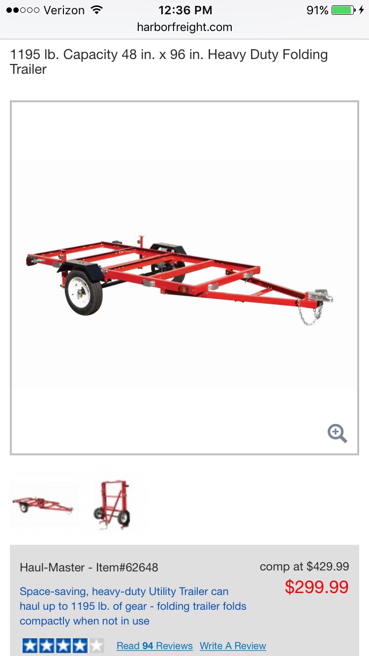

Thanks Stoney and that's what I'm worried about not having enough storage space for a family of 4 especially in a JKU-Rubicon. I've been doing some searching around showed my wife this idea I had and she said go for it. [emoji120][emoji106][emoji106].
So this is what I came up with, with all you guys info, advice and help. I will be getting one of the 2 trailers from harbor freight and reinforcing it by welding all the seams and taking out the folding tongue out and welding a solid tongue on plus I'll be building a frame on top of it for the RTT. Also will be beefing up the axle to a 3500lb and either get 33s or 35" tires. The walls, floor, and storage in front of the trailer will be made out of sheet metal once that's done I'll then rhino line it inside and out. This is going to be a little project but I think it will be worth it in the long run plus I'll be able to store more stuff in the trailer and have the RTT on top of it off the ground. I really excited about this now. Lol
P.S. Oldfooladventures Moak thanks for your video build on your trailer it looks pretty sweet and gave me a lot of ideas and saving some money for some other goodies. Lol. [emoji106][emoji106]
Small size trailer
Large size trailer

You are very welcome. Have fun with your build, and move up to the dexter ez-lube 3500 lb axle asap. I burned up 3 sets of bearings before I learned that lesson. Believe me, it's no fun stuck out on I-70 in the middle of Utah, then a year later on I-70 in the middle of Kansas, trailer laying on it's belly, axle up on the racks, and on the hunt for a new replacement axle. Ah,,, but wait,, each time it was a great story for the grandkids. !!

I bet they were great stories and the grandkids enjoying them. Thanks for the heads up on the axle would you recommend torsion or straight 3500lb axle? Thanks.

What you are building is not my style. Doesn't mean it is wrong. Everyone has different needs, skill sets, time constraints, and budgets. Just don't rush into anything. Try to go to an overland rally somewhere where you will be able to see lots of DIY and production builds. I have a Mt Rainier tent from CVT. It can sleep 2 adults very comfortably up top and 2 below on the ground on cots or ladders. Good luck with your build.

and mine has a torsion axle. Another guy on here is using the Tibren! Oh so many choices.... :blush:
