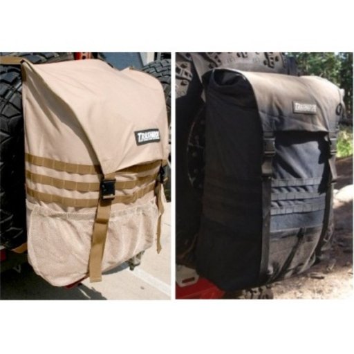

I already have a trasharoo but i didnt think of shoving the tarp in there. I mainly used the trasharoo solely for garbage.

Great looking Jeep! I have owned bags from North Face, Marmot and Mountain Hardware over the years. They have all worked well. I have switched to down top quilts for both sleeping in my hammocks and sleeping on the ground pad. I have a 20 degree Enlightened Equipment Enigma Ultralight Down Quilts Sleeping Bags Backpacking Camping Bikepacking Paddling Hammock Under Quilts and 20 degree Underground Quilts UGQ Outdoor LLC › ugqoutdoor.com They work great and pack smaller than similar size sleeping bags. I will probably order a 0 degree this year from UGO. I wouldn't worry about getting expensive 900 down. It isn't any warmer - just lighter for backpacking.
My trasharoo gets used for hauling a lot of different things. I just make sure trash is in a good trash bag before going in the roo.
