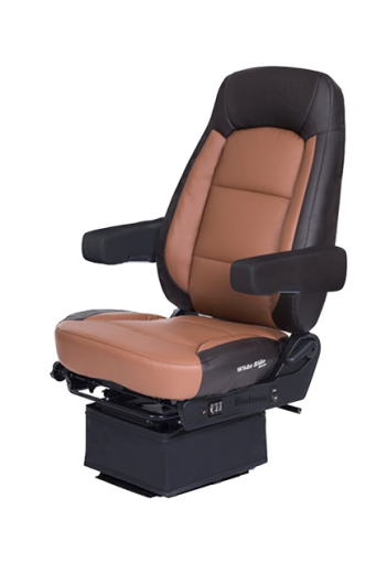

If your back surgery is a major factor in purchasing a vehicle I might suggest looking into upgrading to a air ride or suspension style off road seat. Go ahead and get the vehicle youve dreamed of and upgrade to a seat that will work for you.

Your seats are probably the most important factor in your choice. And I would not limit things by the seats that come with the vehicles. In fact, I would be inclined to pick out the seats that will work best for you and then figure out what your options are for a vehicle that will fit them.
A field trip or two for the sake of visiting some seat manufacturers would be my starting point. Some travel for the sake of your back is worth it. Particularly before your back becomes such a problem that you can't travel.
Give someone like PRP a call and try to set up a time when you can drop in and try out some of their different designs. I bet you won't be the first they have tried to accommodate.
Once you know what you need in terms of seats then you can start to figure out which vehicles will work with those seats. I can tell you that if you are tall then you are likely to have a hard time fitting a typical width seat in an older Cherokee (XJ). The floor pan on the driver's side has a bump out for the transfer case. Aftermarket seats work around this by raising the seats. That is not a solution if you are 6' tall or more.
You may find that vehicles with a passenger side drop T-case are your best bet on that particular front. But I am sure there will be other details you will run into as well.

A Land Cruiser or LX might work for you but like JungleSkunk pointed out, the seat is everything.

I will echo the seat upgrade idea as well. I have driven a few old Peterbilts that will destroy you, but the same spec truck with an air ride seat is quite comfortable, so seats make a HUGE difference. I will also say that a good friend of mine has an OME lift on his new 4runner, and it rides better than stock, so if you lift do your research and it will help too.
