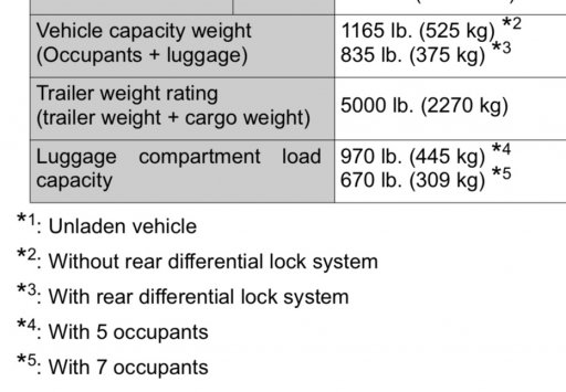

Below is a snip from the 2019 owner’s manual. I take that to mean the GCWR is the max vehicle weight plus 5,000 lbs. I’m not sure how else you would read it, bit I could certainly be wrong.
