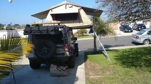

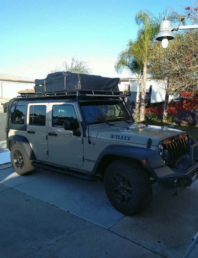

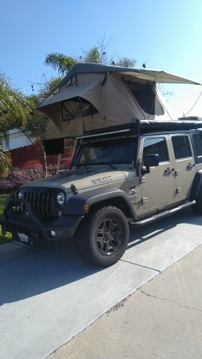

Hey guys I'm new to overloading and finally got my first jeep. I'm looking at getting the GOBI steals rack since it doesn't require me to drill into the hardtop. That being said I'm also looking at getting the Smittybilt Overlander tent. For those that have that combo, is it difficult or do I need any extra mounts to attach the tent to the rack? Also for those that have a Gobi with a hardtop Jeep, how hard is it to remove and put the rack back on? Thanks in advance for any help/info you more seasoned pros at this can provide.
I have the Gobi Stealth rack on a 2017 JKU with the Smittybikt RTT. I added an extra crossmember support. I think each support is rated at 175 lbs. With 120 lbs tent and two adults, I chose to add this additional support.

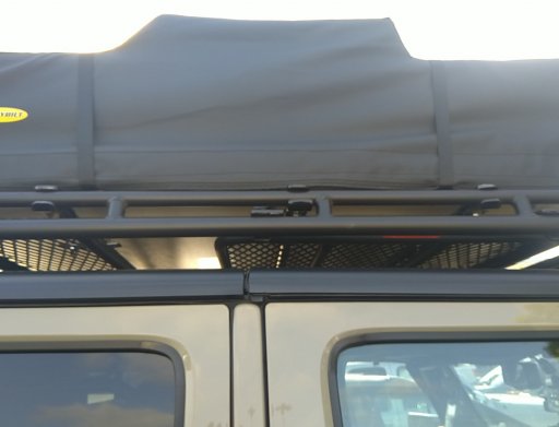

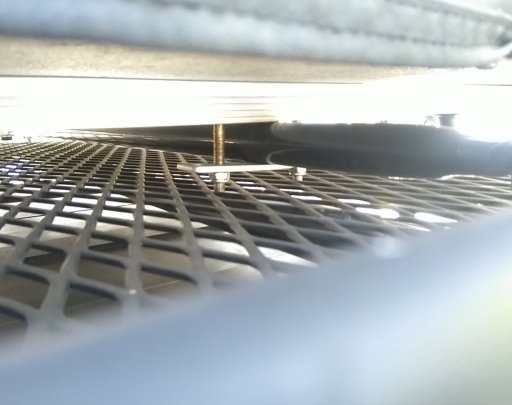

That's pretty much what I was thinking in terms of the extra crossbar. I'd rather pay a little extra for piece of mind. Did you have to get any special mounting brackets or anything to attach the tent to the rack or did you just use the hardware that came with the tent? Also if possible do you have any pics of the tent on the rack just so I can get a better visual idea?
It was a very straight forward install. No special hardware needed. It did help to have my son to help me mount the bars and raise the tent. Without help, you'd need very long arms to put the mounting bolts through the tent floor and attach the washer and nut on it under the tent. Pick the side you want the tent to open to. Connect two of the cross bars to the bottom of the RTT before you mount it. Once the RTT is on the rack, lift one end of tent an place the third cross bar between to the attached to the tent. The middle bar is only attached to the rack, not the tent. It is there to bear the weight. It's getting dark now. I will take some pictures tomorrow of the cross bars and mounting brackets.
I also have the SmittyBilt awning. It is well built and I have the below tent annex. Regarding the awning, the brackets it comes with are L-shaped and are so-so strength wise. I replaced the SmittyBilt brackets with the Gobi brackets. The Gobi brackets are super solid but VERY expensive. Personally, I think they were worth it.
I saw a loss of 2 - 3 mpg with the RTT. With the rack, tent, 4" lift, 35" tires I get about 13.5 - 14 mpg.

Here are some pics of the Gobi crossbars and the RTT mounting brackets. I also have a pic of the Smittybilt (above) vs Gobi (below) awning brackets.

Thanks for all of the pics. They really help seal the deal in terms of going with the gobi rack. You're absolutely right about the awning brackets. The stock ones look a little flimsy and the gobi ones look quite a bit beefier. Have you had to take the rack off at all since you've gotten it? I've seen some conflicting things about it. Ideally, I'd like to be able to take the hard top off during the summer months when it's nice outside but I'm not sure how much of a hassle it would be to take the rack off and put it back on when you need it.
