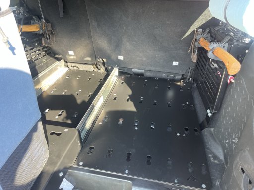

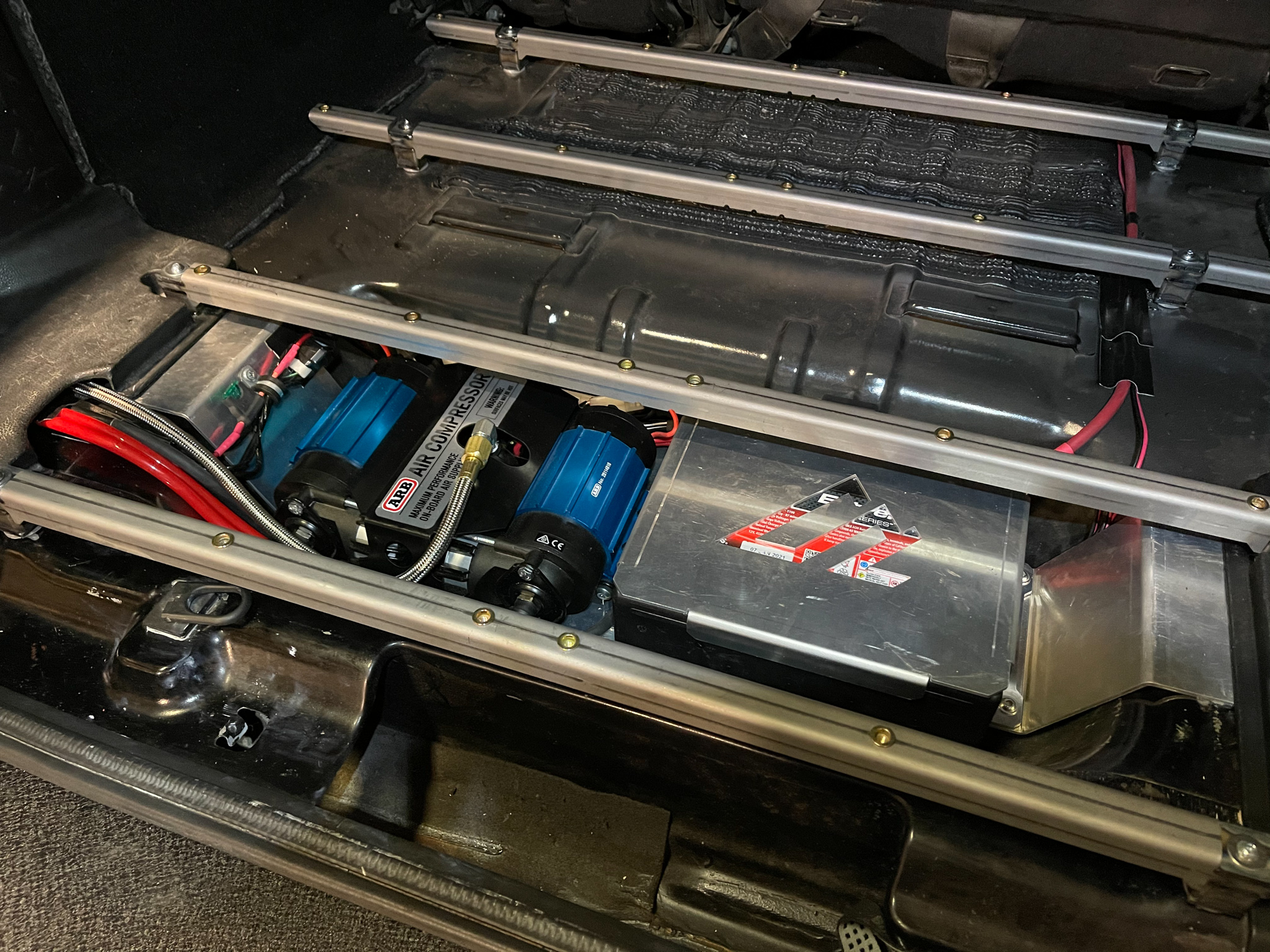

I have a Genesis Dual in my '17 JKU and I recently added a Redarc BCDC1225 in the rear area and installed a 50ah LifePo4 battery as well. What I did was I removed the factory sub from the cubby area and installed the battery in there and I also relocated my ARB Twin compressor in that spot as well. I did it using American Adventure Labs stuff. It'll be easier for to just put the links here than it will be to explain it.
I also added a cut off switch in between the main batteries under the hood and the Redarc charger. I leave my Jeep parked for long periods when I am out of town working. I also added a circuit breaker in between the LifrPo4 battery and the fused panel that I can open to turn off power to the fused panel.
My LifePo4 battery mainly runs my ARB50 fridge that I have mounted on the AAL Flip and Slide and I also have two 6" AAL drawers in the back.
I DO NOT run the ARB Twin air compressor off the LifePo4 battery. That runs off the Genesis under the hood.

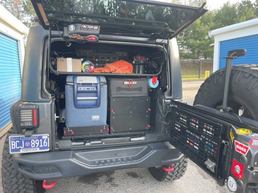

View attachment 268203View attachment 268204View attachment 268205
@HKLover I love the setup. I have a goose gear platform, I wonder if that would affect the performance of the arb or the battery.
HKLover
Ohio/Tenn
Shanower
7170
I don't know anything about how the Goose Gear system mounts into the back of your Jeep, but if you look at the pic that shows the ARB and battery in the subwoofer cubby, you will see the AAL crossbars are raised a little bit off the deck allowing for a little extra room for that 50ah battery. Originally, I ordered the AAL kit for that with a bracket to fit a 30ah battery, but the 30ah battery that AAL recommended isn't made anymore, so the mounting bracket was worthless. I ended up buying the 50ah and had it held in temporarily with some velcro straps till I can make an actual bracket. The other thing about the AAL mounting system is that it has a lot of "L track" holes in the mounting plates and there is plenty of space around the mounting platform for air to circulate.
