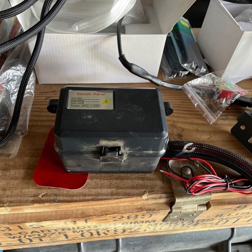

I just got a Niwaker 6 gang switch to start running light on my JK. Does anyone have any ideas where to mount the fuse box? The engine compartment is pretty limited on space. Wire leads are short also. Thanks for any help you can send my way!

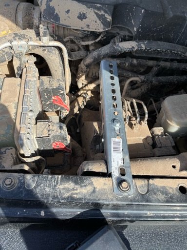

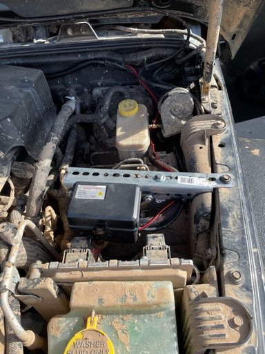

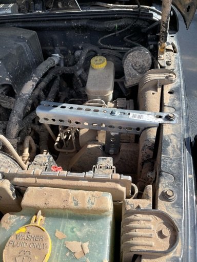

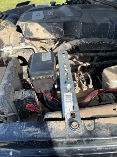

Yeah. It took some work. I had to make a bracket to be able to mount it on the drivers side. Also had to splice all the wiring to reach the passenger side battery. You’ll need to purchase a fuse tap also for one of the wires to hook into fuse box. I can send some pictures if you need them.
Reactions: Constitutional_J
Picked up the angle and straight bar from Lowe’s. Just cut it with angle grinder and cutting disk. If you zoom in you can see where I bolted it in. I ran the wiring back against the firewall along the existing wiring. Hope this helps.
