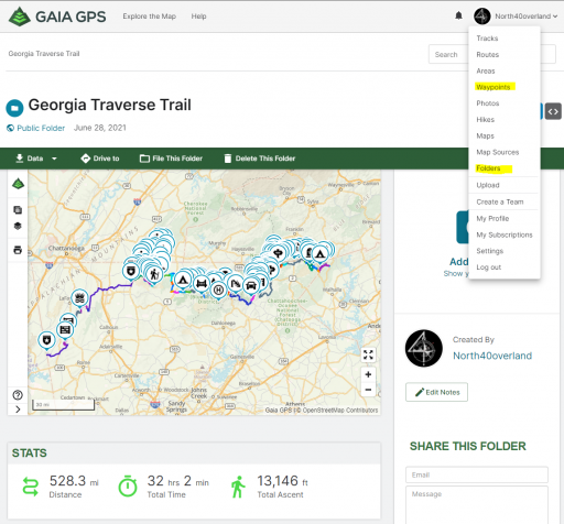

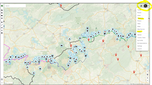

From your computer you have to go to your "account" and make sure that things are organized the way you want them. I like to keep my tracks/routes in one folder and my waypoints in another. You go to your account on the top right of the Gaia map from your computer.
Go to your Gaia "Account"
It will give you a different looking screen. Think of this screen as your cloud account. Everything you do here will populate across all of your devices. It is a bit clunkier than the "desktop map" you just came from but ultimately this is the master record that will drive the desktop and mobile devices. Organize your items here and correct anything you see out of place before you move on to Syncing with your mobile devices. You can also make things public or keep them private here.

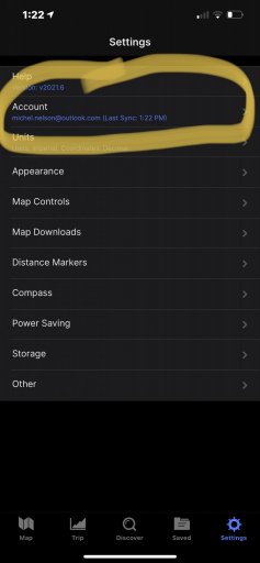

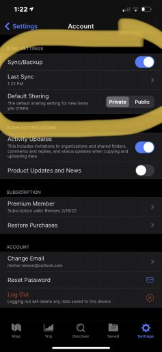

Once you have everything how you like it on your cloud then you go to your mobile device, go to settings and access your account there to Sync.
Click on account to go to Sync Settings. Make sure sync/backup is set to ON and then click on Last Sync to manually update and you should be good to go. You can also use this to sync downloaded maps between devices like if you use an ipad and an iphone together for nav.
