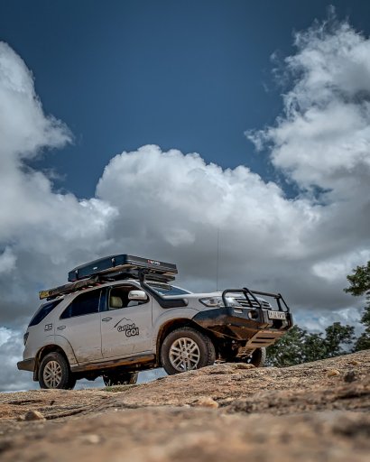

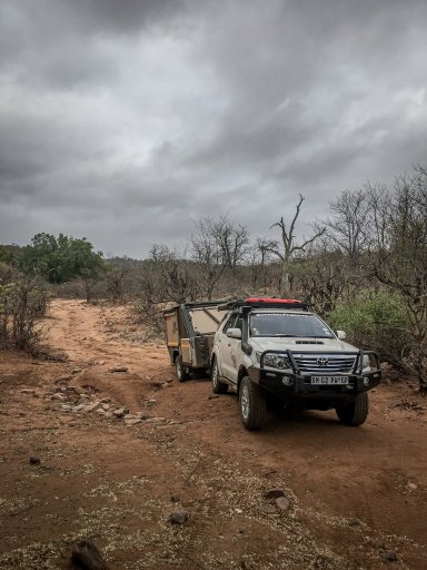

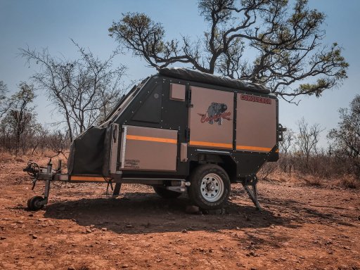

I currently have a Toyota Fortuner (similar to a 4Runner), fully kitted for overlanding and a Conqueror Companion UEV-440 off-road trailer. My other option is to start over with a rig-only config; a LC78 Troopy with an AluCab Hercules (pop-top) conversion.

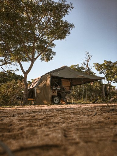

- Base camp; if we're camping in one spot for an extended period of time, we can leave the trailer set up and go exploring with the vehicle. If we're doing one-nighters the trailer does have a minimal config as well (15min) I also have an iKamper mini as an alternative.
- Interior living space; the trailer provides an interior living space which I think is a must-have for full-time in bad weather. It has a 270 awning outside as well.
- More space; between the vehicle and the trailer there is a good amount of space.
- Cost; I already own this setup, no debt.

- Daily driver; the Fortuner is a much more modern and comfortable drive (I've owned a Troopy before)

- Off-road capability; although this trailer is great off-road, it's still more limited in where it can go as opposed to a rig-only setup. Do still have the vehicle with an RTT so could leave the trailer and go vehicle-only on rough trips.

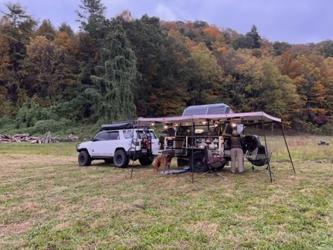

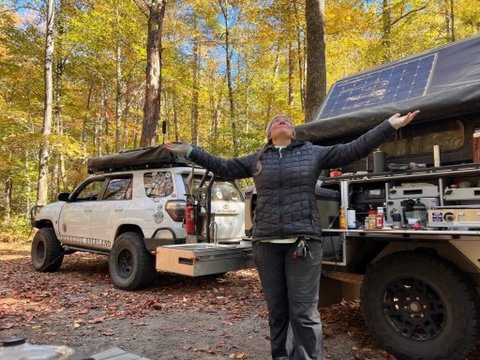

My wife, our dog & I have been living full time out of our 2015 Toyota 4Runner & 2020 Patriot Camper X1H for about 16 months.
In this time we’ve covered most of the North American Continent! We’ve back & forth across the lower 48 twice, did the entire Baja Mexico Peninsula, Alaska & Western Canada!
Our Patriot Camper has been outstanding! We love living on the road with it! For me the only negative would be is that I’m a little conservative about what trails I’ll hit! My big concern is, “can I get turned around.?”
Other that that we’ve never had a problem and the trailer hasn’t stopped us from doing anything or going anywhere!
