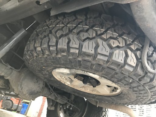

I am on the same search. Input 35s on my pickup. The options I have found either effect the parking sensors, hide the camera view, are a pain to open to get the tailgate down, take up bed space, or add a time of height to the truck. I have come to the conclusion that I may have to ditch the tailgate, remount the camera and possibly go to an aftermarket bumper so the sensors work. On the bright side I am hatching a plan to dump the factory tire underneath and put air tanks there with some armor for airing up and took use.

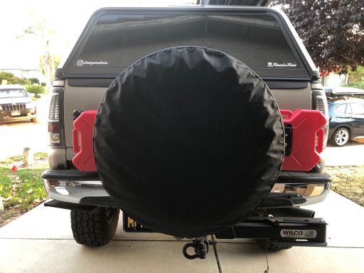

I was thinking a hitch Mount swing carrier ( if one could be found to hold that amount of weight), but I never thought about parking sensors. None of my vehicles have them so I have never taken that into consideration.

Mine is on a swing out tire carrier on my pickup. However I built the bumper, have no backup camera or sensors, and open it every time I get in the tailgate.
however I do have a full size matching spare wheel and tire, i Rotate it in when I rotate my tires, and will get way more life out of them too.
the trade off for knowing I have the exact tire if I get in a bind is great.

Keep mine in the bed strapped with ratchets, can be moved as needed for different cargo. I didnt remove the spare winch mech so I can throw it under there if I need full bed space.

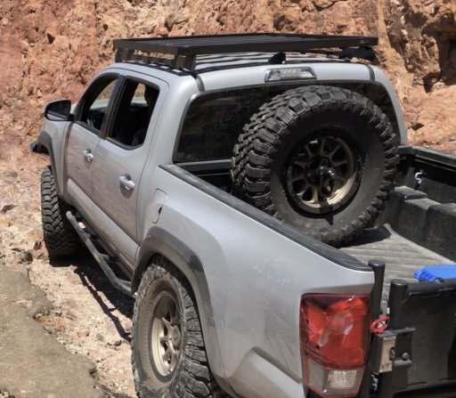

I found this mounting attachment from Wilco Offroad and it bolts to the Toyota factory bed rails (I think it would work for Nissan trucks as well) and securely holds your spare up against the side of your bed, either behind the cab or along the side. The current price is $275
(Not my truck, Wilco Offroad stock picture)67D61C0B-576F-405B-B0C8-288D77834750.jpeg
