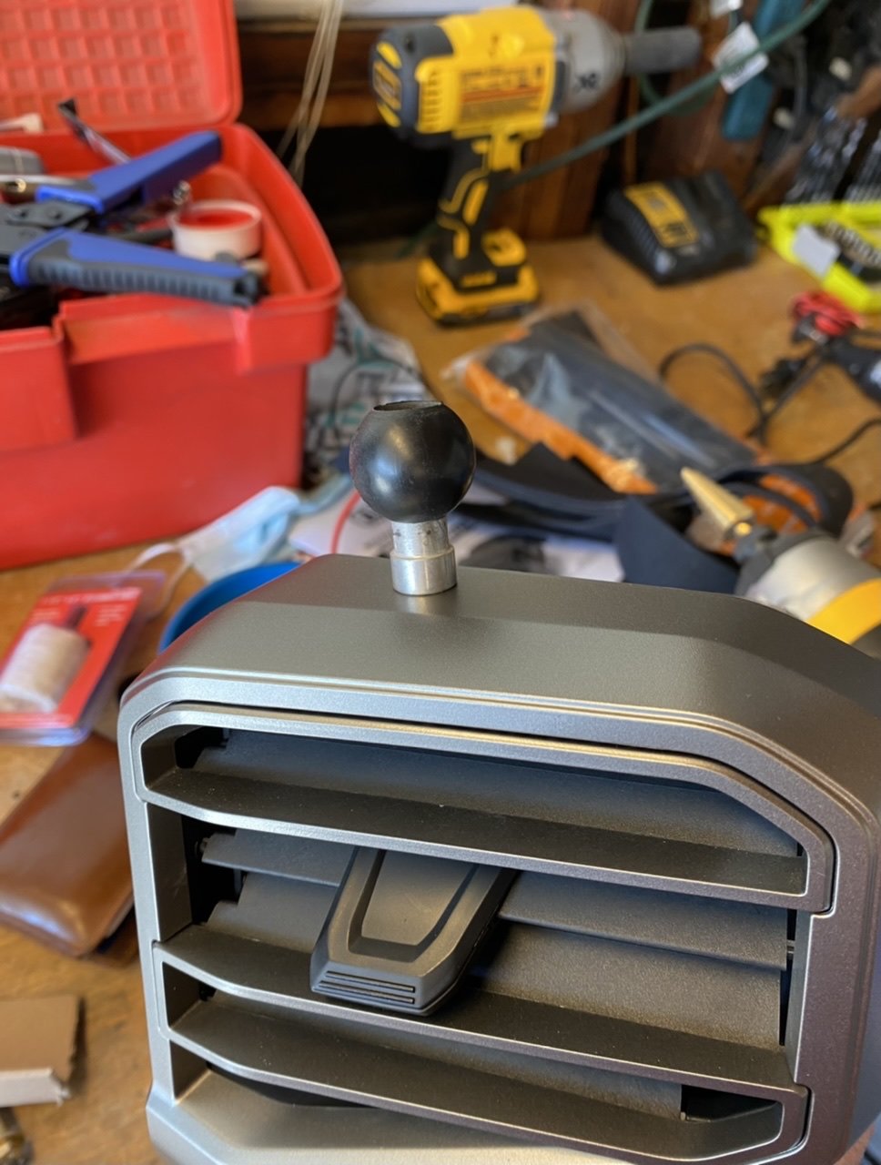

Tent Heater-
the full diy write up Propex Heater Build to iKamper Roof Top Tent
Bought a nice 5lb propane tank mount for my rack off Etsy for my next project because now that my wife and I live up in North Idaho we decided to invest in heat for our RTT set up because it gets cold! I decided on a forced air propane heater due to nearly zero maintaince and I already carry propane. Now we have heat!
[IMG]
Camping Diesel Heater Rotating Dual Tent Vent Assembly - Etsy
This Car Accessories item by CounterCultureShop has 44 favorites from Etsy shoppers. Ships from Garden Grove, CA. Listed on Jan 26, 2024
[IMG]
www.etsy.com
[IMG]
Propex HS2211 6500 BTU Exterior Gas Air Heater
The Propex HS2211 is a weatherproof, externally mounted gas air heater, perfect for keeping your van warm during cold weather while saving space!
[IMG]
vancafe.com
Workflow: pop the tent, open the ammo can, pull out attached hoses and tent window pass through, power up the heater from the master switch, select temp in the tent on the control panel and bam! Heat!

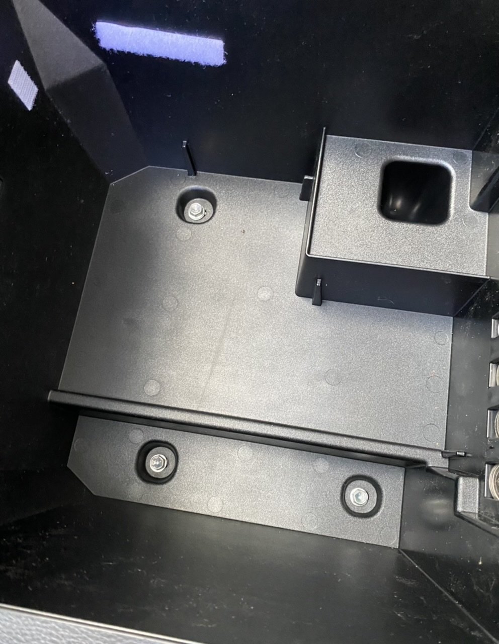

I installed an X2 AGM battery to replace my stock 75AH battery with 92AH. The X2 Group 94R fits nicely as a direct replacement and has 81AH 159 reserve minutes of capacity. I opted for the larger X2 27F which has 92AH and 190 reserve minutes of capacity. The 94R is 7.4” (about stock) in height whereas the 27F is 8.75” so I thought about getting fancy and making a new center bracket. But I didn’t.
There is a bottom bracket which secures the battery into place and the center strap is secondary. I reversed the bracket and bent it to fit. Isn’t too pretty but it fits nice and snug. The battery cables reach just fine and overall pretty easy.
Reversed the bracket then gave it some mallet love
The bolt is cinched tight

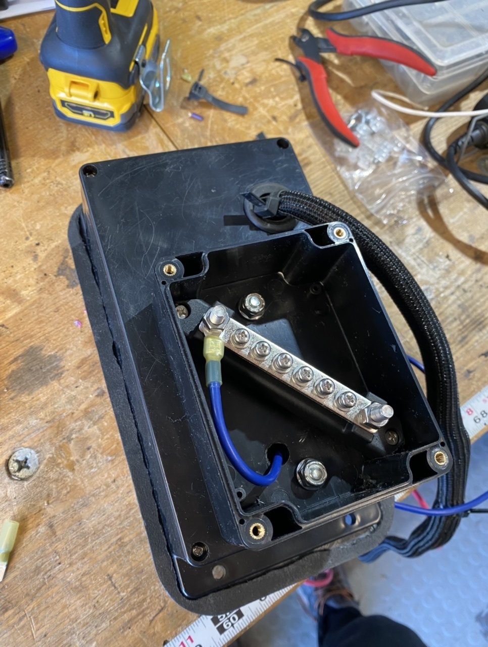

I added solid LED’s to my 270 awning, used a project box for my electrical junction box, and bought a dimmable switch that is fully waterproof. I put the LED’s on every other support bar so it wasn’t too much, it is camping after all……ha

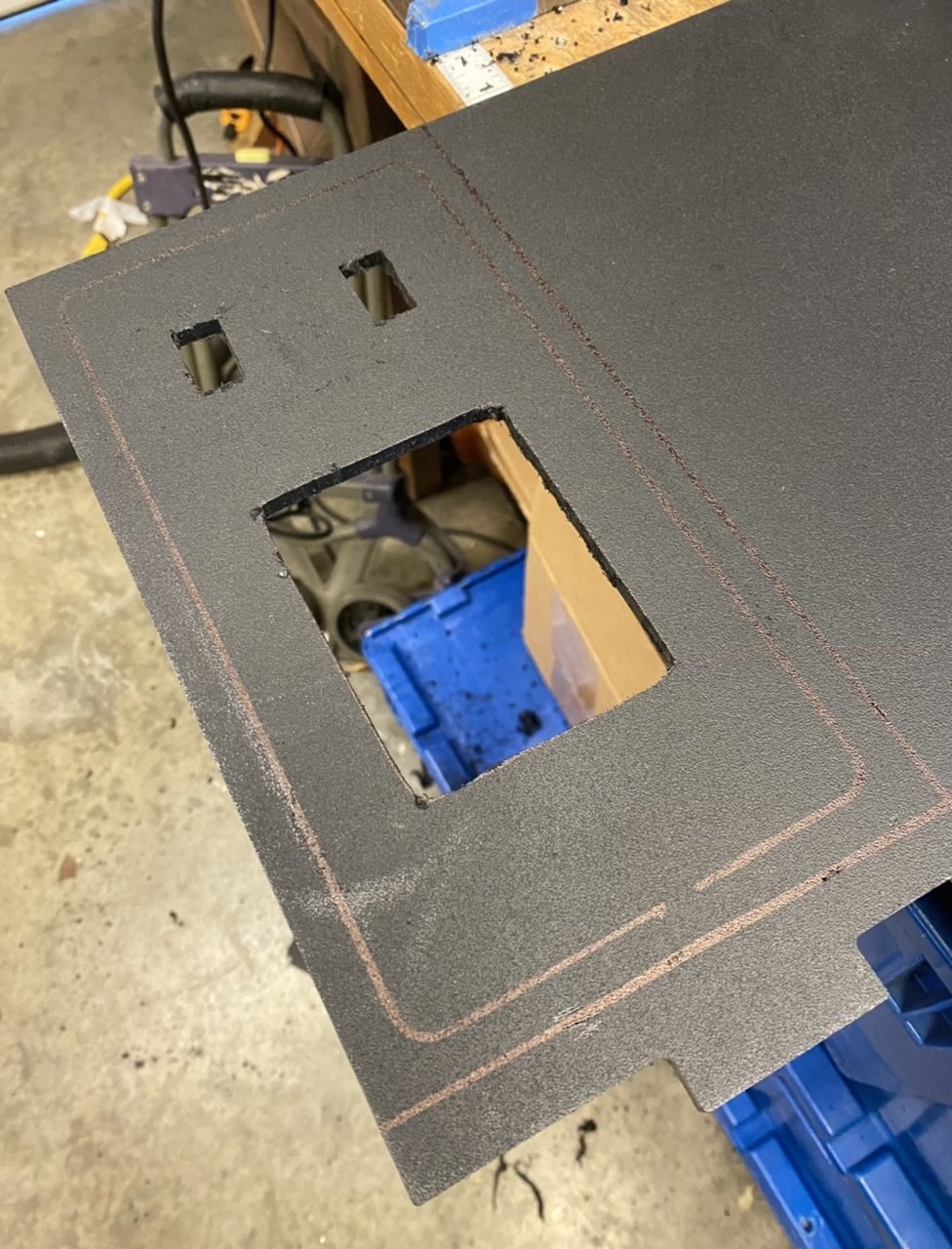

I made an ammo can fire pit, I added rounded lava rocks later. I made a mistake on the cut so I fashioned a fire emblem to cover it up

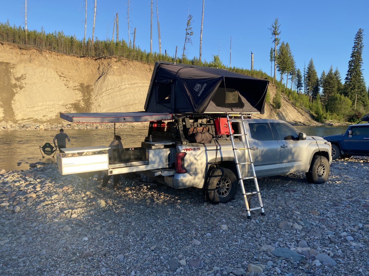

The North Idaho OLB group had a trip to Lake Pend Oreille and it is very satisfying to have all your gear work well and make sense for what you need to do!
