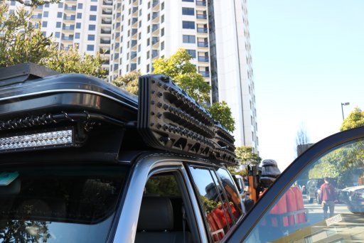

I also have 4 but I need to build a mount to mount them to the rack. Currently on the spare tire, but this works. Most trips out only 2 go with but if I had to take them, both sets are available. I also have the locker, winch, straps, block, etc, so I'm not really worried. But if you think 2 pairs are expensive, what would it cost to recover your rig from the middle of nowhere, now compare prices.
