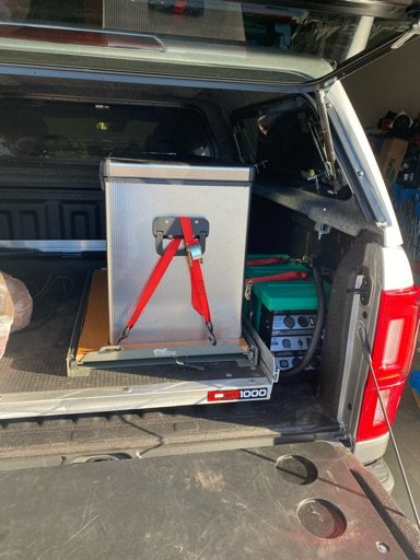

I have a 2020 Ford Ranger. Any ideas on how to shut off the smart charge feature in the battery management system. I called three dealers and no answers. Running national Luna green box and would like to just run with standard alternator voltage.

Thank you! Very new and have the system installed but concerned won’t get enough charge even if my ignition sense port is plugged in. Trying to decide if there is a way to get alternator to work likes the ones of old or put in a 12 volt port to serve as ignition sense in the truck bed? I am getting very low alternator readings. Down to 4 amps when at idle so not sure even with ignition sense will fully charge as I am driving or just want to bring up battery while at idle at camp?
It could be that the alternator is not producing power because the primary battery (and, if connected, your auxiliary battery) is fully charged and there isn't much load on the system, which means the Smart Alternator is doing what it should. From the 2019 US Ranger service manual, "Generator amps at 80.6°F (27°C) 105 amps at 750 rpm (min) to 170 amps at 2,250 rpm (max) ". Check the Ignition Sensor lead to confirm you are getting positive voltage when the engine is running. If so, the next thing you might try is to deplete the aux bat a bit (burn off, say, 30Ah) and then take another measurement with everything hooked up and the engine running. Your GB unit monitor should then show a solid 25A of charge being applied.

Holy Moley- this forum was worth the price of admission already. I will give that a shot. Trying to get as much as possible right the first time. Thank you!
