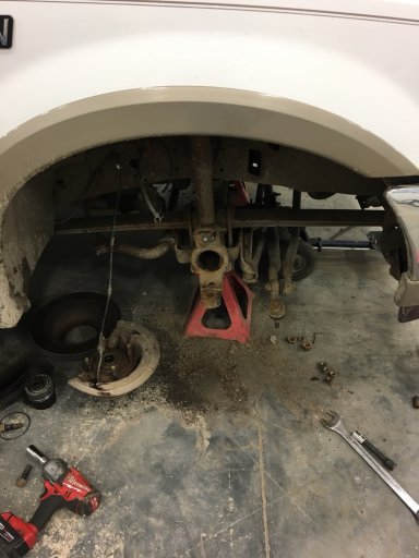

Got some maintenance items taken care of before our trip to the Nebraska National Forest in Halsey NE. 2 of 4 ball joints were toast and right side u-joint. IMG_1282.JPGIMG_1283.JPG
