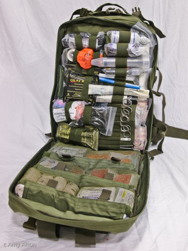

I carry an intermediate kit, put together by myself with advice from a Doctor who works for me. I volunteered to be one of the first aiders at work and as such get up to 3 days training each year. It really is surprising just how quickly you forget what you have learned when you do not use it regularly.
I have also asked my local gun range to set up a specific training day on dealing with gun shot injury, but nothing has yet been arranged. Hopefully they will set something up next year.
