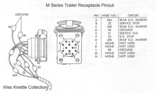

I will try a few of these since I am a past owner of a 24v military trailer M116A3. Personally I cut off the NATO connector and hard wired in 4PIN standard wiring so anyone could use it. I suppose if you had both end of the connector you could make your own adapter. There is a lot of wiring diagrams out there here is one that I found with a quick search. There is a lot more resource here: http://www.steelsoldiers.com/

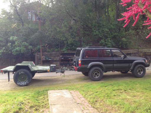

Would that drawring be relevent to all nato trailers or just US MILITARY
No idea do not have any experience with NATO equipment but US is the largest equipment provider of NATO equipment? You would have to look at the wiring and see if there are the steel stamped labels on the wires that correspond with the above diagram. In any event its easy to use a continuity tester to figure out what the connectors are doing.
