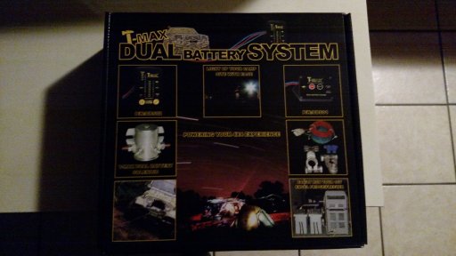

Well i'm about to start a dual battery monitor system in my truck . the one i bought is this oneIMG_20161128_203733155.jpg
anyways i have noticed that it did not come with any mega fuses . So i'm curious about what kind of systems all of you are using , and when i get the mega fuses should i get them at 100 amps same as my alt. puts out ?

@87comanche Do you have a parts list you can post for that kit? I'm curious on the wire size. But yes, a 100 amp should work for most dual battery kits. Just put it as close to the battery as you can.

Well the cable the kit came with is 6 awg . I've been thinking about changing it to 4 . other than that the solenoid is 12v , the led monitor looks very similar to the one that's national Luna has.
