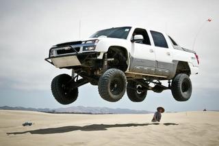

I ran tires without bead locks on my old long travel truck running into the 10-12 psi range. 35" tires on 15" rims. The sideways force doesn't get much harder than that and never lost a bead. I run my tires at 15psi now in the Tacoma on 33s with 16" tires and again never lost a bead (knock on wood) nor do I have fear of it. Are they NEEDED, definitely not.
With that said we did run the staun internal bead locks on our race trucks because well while it never happened we'd be damned if we were going to lose a race because of it.
The old LT truck and yes I was hard on this truck as I am all my trucks.
