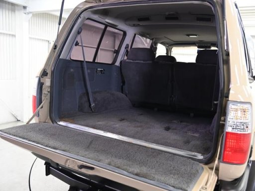

I’m in the process of brainstorming to build my own drawer system, for two reasons: #1 they are very expensive, #2 I’m in Japan and most manufacturers don’t ship to my FPO, AP address.
My question is, since I don’t have a garage, what are some basic tools that I could buy that can get the job done but I wouldn’t need a garage to house them. I do have a small backyard which is where I intend to build it. Also can you guys share some pics of your drawer system to get some ideas! Thanks!

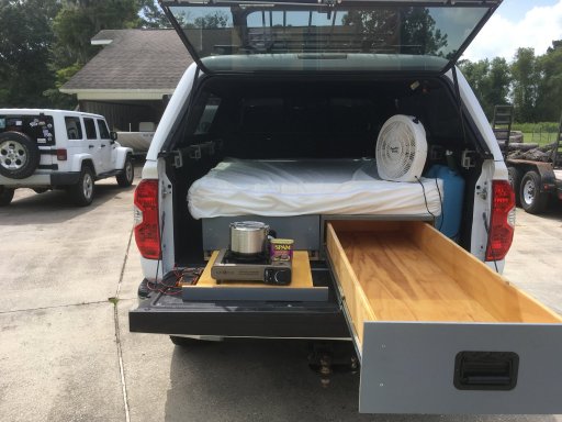

Most home improvement stores can cut wood for you. If you come up with your design, you could just have them do the cuts, and then you put it together.
Here's mine for some inspiration.

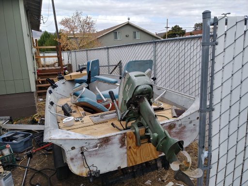

Tools needed are a skill saw, drill with screwdriver bits and a drill bit for pilot holes for screws, and tape measure. A jig saw is handy, but not required.
I built a boat deck with just a skill saw, tape measure, and electric drill. Just as an example of what can be done with minimal tools.

i did a long drawer setup so we could sleep on top of it, but its essentially the same thing if you shorten it and make it taller, etc
@M Rose is right about the tools. if you go with cordless tools, you can even take them with you on trips. i usually take a cordless drill and sawzall with me and i also have lights, fans, and radio that use the same battery pack, so its a bonus if you go that route. a drill and circular saw will be plenty enough for this.
as far as design, @reaver has a good set up and its modular. maybe do a short base with drawers and then have 2 separate units on top so you can remove one and add a fridge or just be able to change up things easily if needs be. no matter how great your set up is today...chances are you will want to change things down the road, so making it modular is really nice. plus if you need the back room for something, its easier to move and store it if its in several smaller pieces
