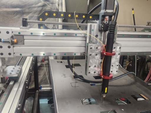

I have been working on building a CNC plasma table, for the last several years.
![20240321_165120.jpg](/forums/data/attachments/283/283518-683ecb6971a738e05b8b199a81fa5854.jpg)
![20240225_142309.jpg](/forums/data/attachments/283/283517-83c43c6ab63682be7c1b63ad28382be9.jpg)
Couple of pictures to show the style and scale of that build, Because I sure there is someone who is interested.

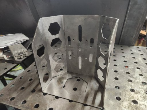

well today I finally put this long term project to work making something useful I was in need of. A holder for a 5LB propane tank that will get attached to the roof rack I built a few years back.
![20240824_164655.jpg](/forums/data/attachments/283/283515-71c1cb9405719e1b1c585fea39894cd8.jpg)
The parts cut from 12g mild steel. I used a bauer surface conditioning tool to clean up the old paint from the metal

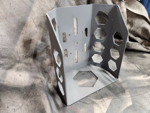

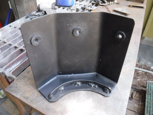

Parts where bent on my small press brake. It was a quick project so I kinda just eyeballed the bend placement and took a bit of tweaking to get it all to fit
![20240824_185406.jpg](/forums/data/attachments/283/283520-bc686a118e2726263749bb0fc905566e.jpg)
All welded up, and a coat of primer.

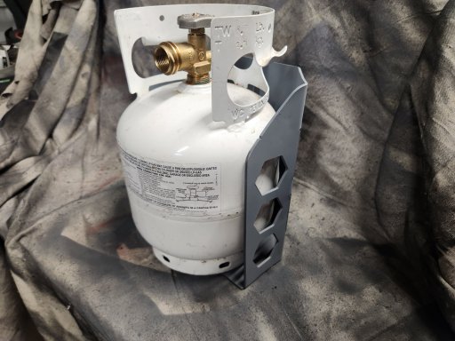

I need to buy the clamps to secure the tank to the mount. the original design looked like they used a couple of stainless hose clamps.
