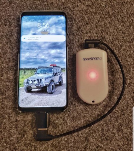

Between the two, if you travel a lot, I'd pick the 5100. You load up 1500 the repeaters with their geo position and the gps/your location will give you the closest repeaters to where you are. That's invaluable!
Then you get a hotspot and the world comes to you. Screenshot_20190330-211723_QuickPic.jpg
