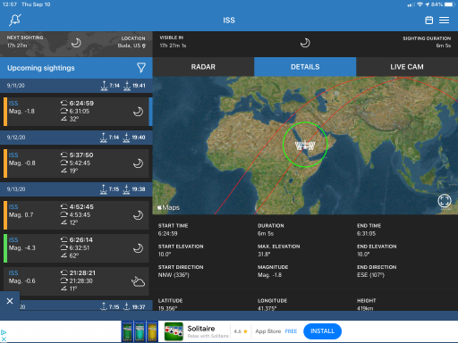

I wouldn't "point" the radio at it, but yes if it is passing over your area you should be able to hear it.
@Shokgoblr if you hold your HT antenna perpendicularly to the ISS you’ll have the best signal.
Back a few weeks ago when MIR was still up there, I used to use a mag mount stuck to my front door to hear the 2 meter signal. The radiating element was horizontal.
