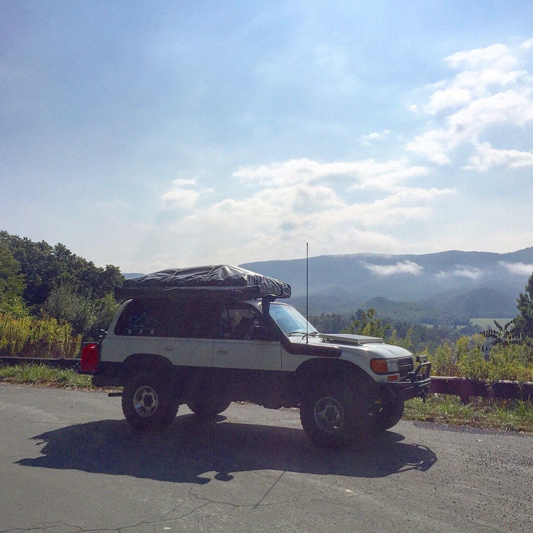

I would go with the fridge setup. I'm looking at putting solar panels on the roof rack for constant voltage. I have a dual battery system already. Anyone familiar with doing this kind of setup?
That’s the way to go. We’re running a Snomaster 82d Expedition dual zone fridge freezer in our 80 series. I have a dual battery setup with an 80watt solar panel on the hood. Works pretty good![emoji1303]
