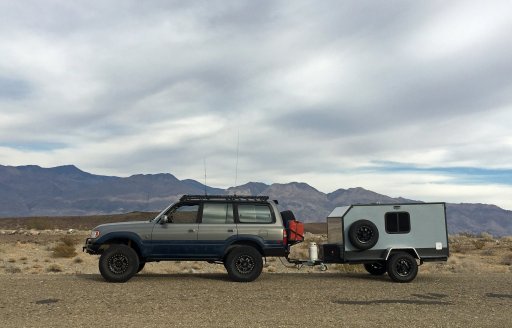

I personally don't like the noise of the Pintles. On my M-100 I built a multi axis hitch after running a pintle for years. That trailer was pulled down black diamond trails. Due to the noise, I would run a ball mount on the street then switch to the pintle at the trail head. When towing down something hard core, I found that shifting the weight in the trailer so the tongue had very little weight (once on trail not street) improved how it towed over obstacles. The pintle likes to have a bit of weight on it or it will bang around.
I now use a tear drop style trailer and have gone back to a ball mount. This trailer has been pulled down moderate trails and over rocks needing a 33" tire to clear without difficulty but its mostly just dirt roads. I did this due to simplicity. I can run the multi axis off the M-100 but wanted to see how it did with the ball mount. It worked out well so I'm leaving it with a ball mount.
More than anything, you want to have the trailer tongue able to adapt to anything. Mine are made from 2" hitch tube. I can swap out diffrent styles of hitch, add length if needed and remove the hitch for security. With this feature I was able to experiment with diffrent types of hitch over the years. I always try to find what works best for me.
You will get diffrent opinions from people and the bottom line is, what works for you.
Heres the two trailers to give you an idea on the size. The M-100 in the picture still had the pintle and the teardrop has the ball mount.
More than anything, you want to have the trailer tongue able to adapt anything. Mine are made from 2" hitch tube. I can swap out diffrent styles of hitch, add length if needed and remove the hitch for security. With this feature I was able to experiment with diffrent types of hitch over the years. I always try to find what works best for me.
