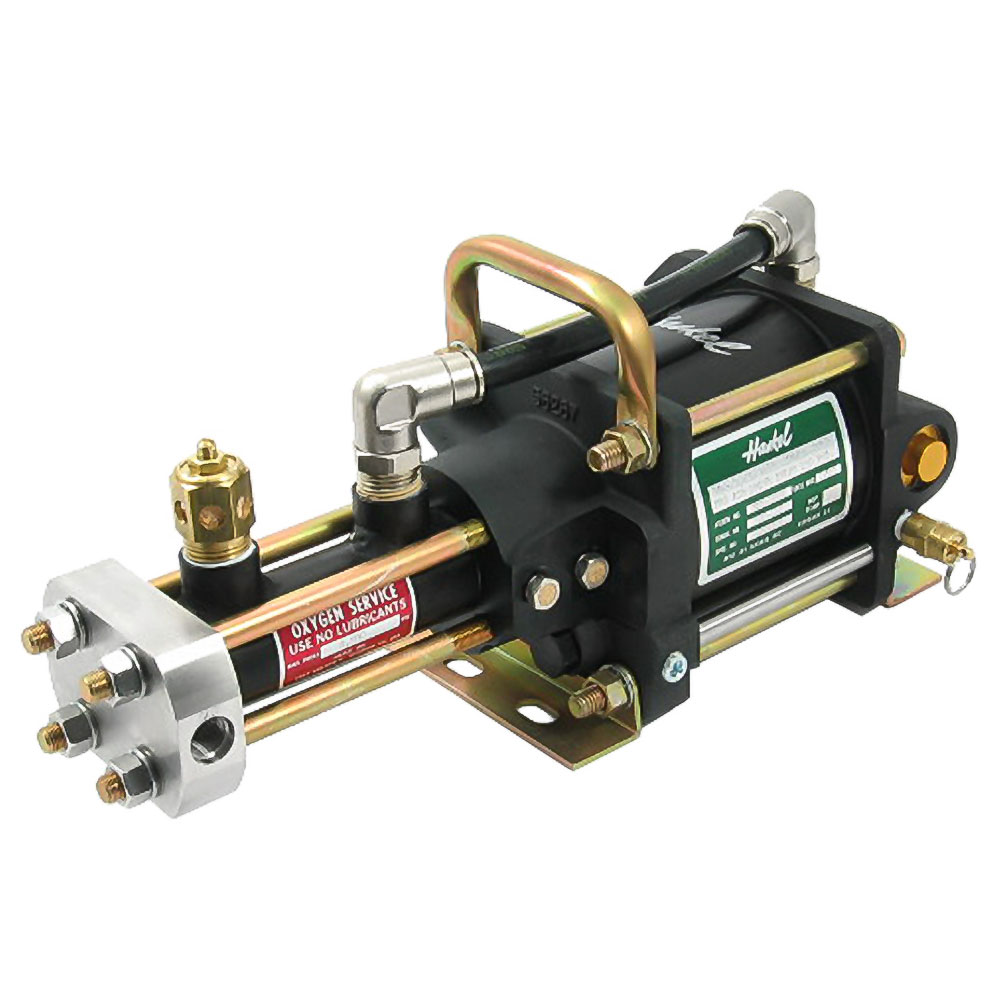

You can fill your Powertank from a welding supply tank. You'll need a booster, and a 150psi compressor.
You drain from the big tank, into the empty tank, when they equalize, turn on the booster. This is how paintball shops fill 5000psi into our markers tanks, from a 3000psi cylinder. Co2 only needs boosted to 860.
