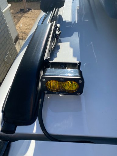

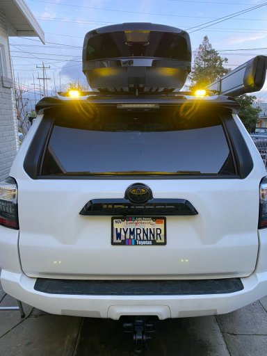

Are folks just using chase lights as a static always on when in convoy, or are they being wired in to vehicle electronics as running lights/ brake light additions?
ntsqd
The rules for a desert race vehicle are that the Dust Light must come on with the ignition.
I have the Dust Light on my chase/support truck on a switch. Don't need it on all of the time, not even when in the dirt.
