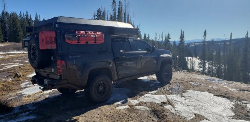

Some great feedback here from others. My truck is only configured with a 21-gallon tank, so I carry two 3-gallon Rotopax fuel cans. They have exceeded my expectations for durability and being leakproof during extreme use and conditions on the road and off. I have only need to use the fuel from the once when my route was cut off by a fast-moving wildfire that required us to backtrack 52 miles on jeep trails to get to a safe area. Had I not had them, I may not have made it. I have also used them countless times to aid off-roaders, UTVs, ATVs, snowmobiles, motorcycles when in the backcountry and motorists on the hard roads. For that and the peace of mind of self-rescue and helping others, I will always carry extra when I can.
