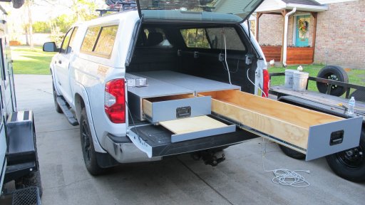

i build a lot of things that cost more than buying, but i do get exactly what i want and usually a lot better quality. some times there is a big savings. i wanted a decked system for the tundra and buying a nice one was around $1200. it was plastic and metal and very well made, but the drawers didn't pull out far enough, so i built my own out of 3/4 plywood and it ended up costing around $600...half price. the 60" slides were crazy expensive, so i decided to build my own slides using 5/16 bolts and roller skate bearings with angled aluminium. i spent a good bit of time and money on the slides and never could get all the rollers to line up perfectly and the drawer kept binding, so i did have to give in and buy the expensive slides. they do work great and sometimes i find i can only go so far without needing to buy certain things that are factory made.
so, as to the OP's question of what we are building ourselves, this is my decked system that does exactly what i need and just so happened to be cheaper than buying
