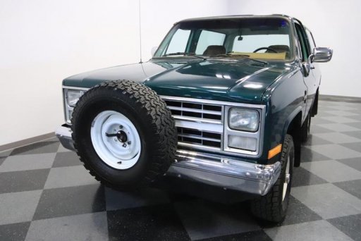

I'm liking MidOH's solution more every day!
With everyone's words of warning, I think the most livable option will be to mount it up front. I've got my eye out for a used brush guard or bull bar. I have access to a welder and have been looking for an excuse to practice.
I think it would look bitchin but am a little afraid that it will lead to overheating issues on slower trails. Which means installing an electric fan (in addition to the OEM - hell'ya there's room for a low profile E-fan!!)
I had a front mounted spare on a truck many years ago, I was great until the mount broke, it was about 100 yards before I figured out what that big bump was.
Um...the spare tire or the canoe?
Heh heh.
I'm not as much a fan of that either but to each thier own. The extra damage to other cars and people in the event of a road crash is probably why we havent seen a stock front spare tire mount since the 1970's. I'd be surprised if it was still legal
I think it would look bitchin but am a little afraid that it will lead to overheating issues on slower trails.....
You could always drill a few exter holes in the rim....lol....just kidding. My,....just thinking out loud here,...My only concern would be air flow. I am going to assume that in front of the radiator, you also may have a trans cooler, and an AC condenser. If the truck stays cool while climbing grades, and off road, I would caution against corrupting a good functioning critical system/s just because you do not favor an added step to open your rear door/hatch (rear swing out).
You said you have a welder and want to learn...there is a lot of info out there on how to weld and on rear swing outs (dirtlifestyle on YT just built one).
Just my .02 cents. (Fyi, I am a welder in Nuclear Power Plants....you CAN do it!)

Isn't the Trans cooler on a modern burb about the size of a two slice toaster? Make sure to put the spare tire in front of that.
