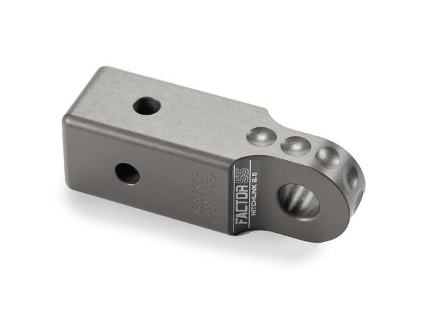

Or should I get a specialized hitch like the factor 55 one?
Factor 55 00020-04 HitchLink 2.0 Reciever Shackle Mount 2 Inch Receivers Black

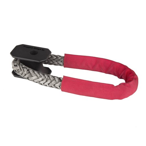

If it is set up for a D-ring I would say yes you can use it with any other brand of setup I just wouldn't use it with the hitch pin in the hole in the hitch. I know some people do but I really wouldn't recommend it. Rugged Ridge has a small block that goes into a hitch receiver as well that is nice and compact and light.

Oh that’s so good to know. Thank you so much for your input. And also for the recommendation for the rugged ridge product.

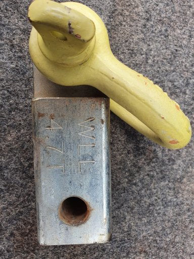

As I said, here in Australia hitches are rated - this is mine and it is rated to Work Load Limit (WLL) of 4.7 ton (4700 kg) which is about 10 362 lbs; having said that, you can buy cheap stuff off of EvilBay that won't be stamped but I only purchase my recovery gear from reputable retailers.

Sorry, I should have said 'Work Load Limit (WLL) of 4.7 tonne (4700 kg) ' - tonne is also another word for metric ton which is the word we use in Australia.
A tonne (or metric ton) is 1000 kg - 4.7 x 1000 kg = 4700 kg.
Using this converter (Conversion Calculator) 4700 kg = 10 362 lbs
Hope that clears any confusion.

2.5 or a 3 from Factor 55
