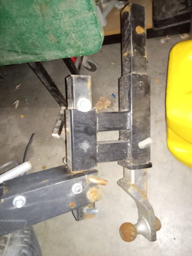

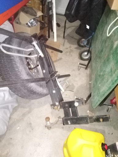

I built mine from a bike carrier. I attached a spare tire bracket from Amazon and a hitch extender and a double hitch receiver. It still holds two bikes if I want it to. I added some hitch shims to stop it from rattling or bouncing. Works pretty well so far.

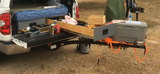

i bought a swing-a-way hitch mount but instead of using it for a tire, i put a tray on it and carried my full ice chest and 2 jerry cans full of fuel. probably close to 150 lbs worth of payload and it did fine. we had it out at black gap (west texas) and it got bounced around plenty with all that weight and never had a problem. i bought a cheaper one, so i'm sure the more expensive versions, like rigid, would do excellent. i guess a solid mount would be stronger, but i really like the swing away so i can get into the back of the truck without having to remove the carrier.
so yeah, i would definitely trust a hitch mount carrier
