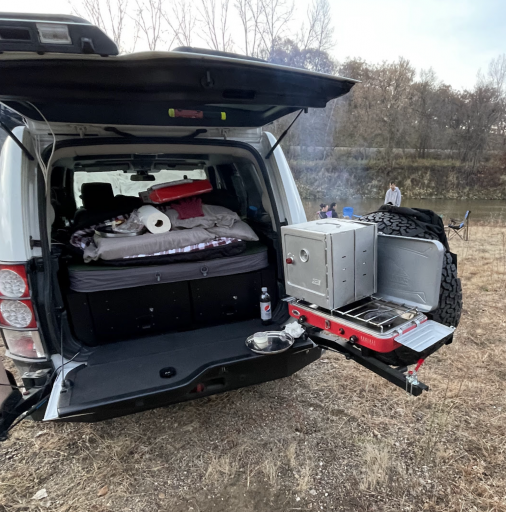

I used a Camp Chef Everest for years. It is a nice stove for high altitude and wind. But IMO 40k btu (20k each) is too much. It is very challenging to get a low heat flame with the everest stove.
So I just recently got my Cook Partner stove and they are 10k btu each burner. That is plenty of heat. My most heat intensive need is my coleman folding oven. I can easily get it past 450F with the 10k burner.
The other HUGE factor for me was just good burners and burner control. The control valves on the cook partner are next level good. So easy to control the flame and get a nice low flame if you want it. They use some very different hardware than all the other stoves I have used/seen. They have a special propane regulator, hoses, knobs, needle valves, etc.
I ordered the 16" and cut the lid off and installed it in my drawers all plumbed up to 1 lb propane bottles under a little shelf. It is a great setup so far. Highly recommend. It did take me about 5 months to get my stove though. I just got it before the MOORE expo and I saw that some vendors had them in stock at the expo. oh well.

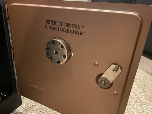

I bought something else that is totally unnecessary and silly for my over priced cook partner stove. I have had a coleman oven for awhile. The newer ones are all aluminum. They are fun for cooking pizza or cinnamon roles and such. I recently heard about the old ones and how they are steel. I ended up buying a coleman oven from the 1960's that was brand new in box.
It is USA made and feels so much nicer than the aluminum ones. It goes together better and feels a lot more solid. Talk about bougie.
Can you even buy leaded gas anywhere? LOL.
