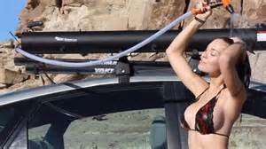

th.jpeg Has anyone built a hot water supply by using black pvc pipe a schrader valve and mounted it on their roof? You can pressurize the pvc with a small compressor to get water pressure.

Pressure won't last long enough. Water doesn't compress, PVC doesn't stretch, and to have enough air to hold pressure you'd need 2:1 (at least) airspace to waterspace.
Now, hook up a low flow 12v RV water pump and you'd have something.
I swear I just had this discussion. Might have been one of my popup forums...

Yea i had a friend that was telling about them, I know seems like it would be more work then it is worth.

I thought about trying to build one with PVC but also decided it wasn't worth it. Additionally the reasons cited above probably make it unworkable. I sure do miss my Australian shower from my Army days. Might have to rethink that again.

In process....
Built this the other night during some downtime at work. It will be mounted on the lid of my mini adventure trailer.
