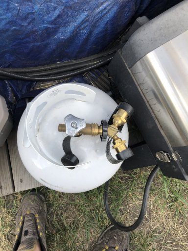

turtle.stampede,
Is this what you mean? This is my old Camp Chef stove. I bought the “Y” fitting to use Two hoses, one for my lantern, and one for the stove. I bought this at Sportsmans, but have seen it at Walmart too. Vance.CDD6D58C-43B0-4A4B-A1C3-BA4CEC991316.jpeg85F49637-B915-4A25-BB0C-5A6C7A67EBDE.jpegEC2A0427-8026-4247-8031-7C0AF333254E.jpeg

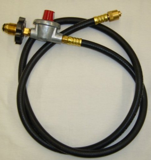

Getting the right hose and regulator for your stove will depend on what you have for threads after you remove your flimsy 1# line. Might be fairly standard and you'll find this will work:
It is from Cook Partner Stove and meant for cook stoves. You can read more about it here: Cook Partner Hose and Regulator . I would double check the connection thread diameter, and pressure needed for your stove to see if it works with this.
