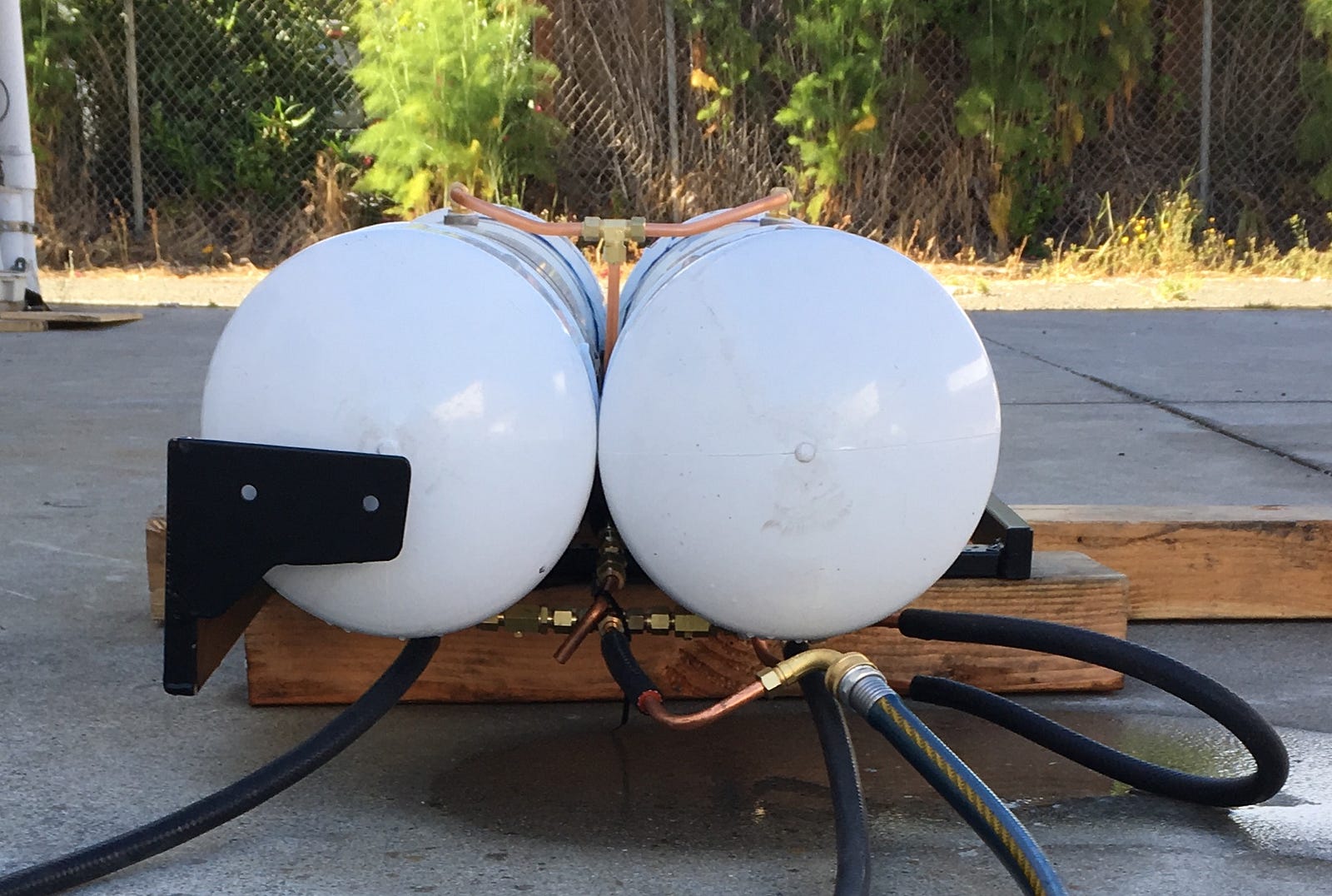

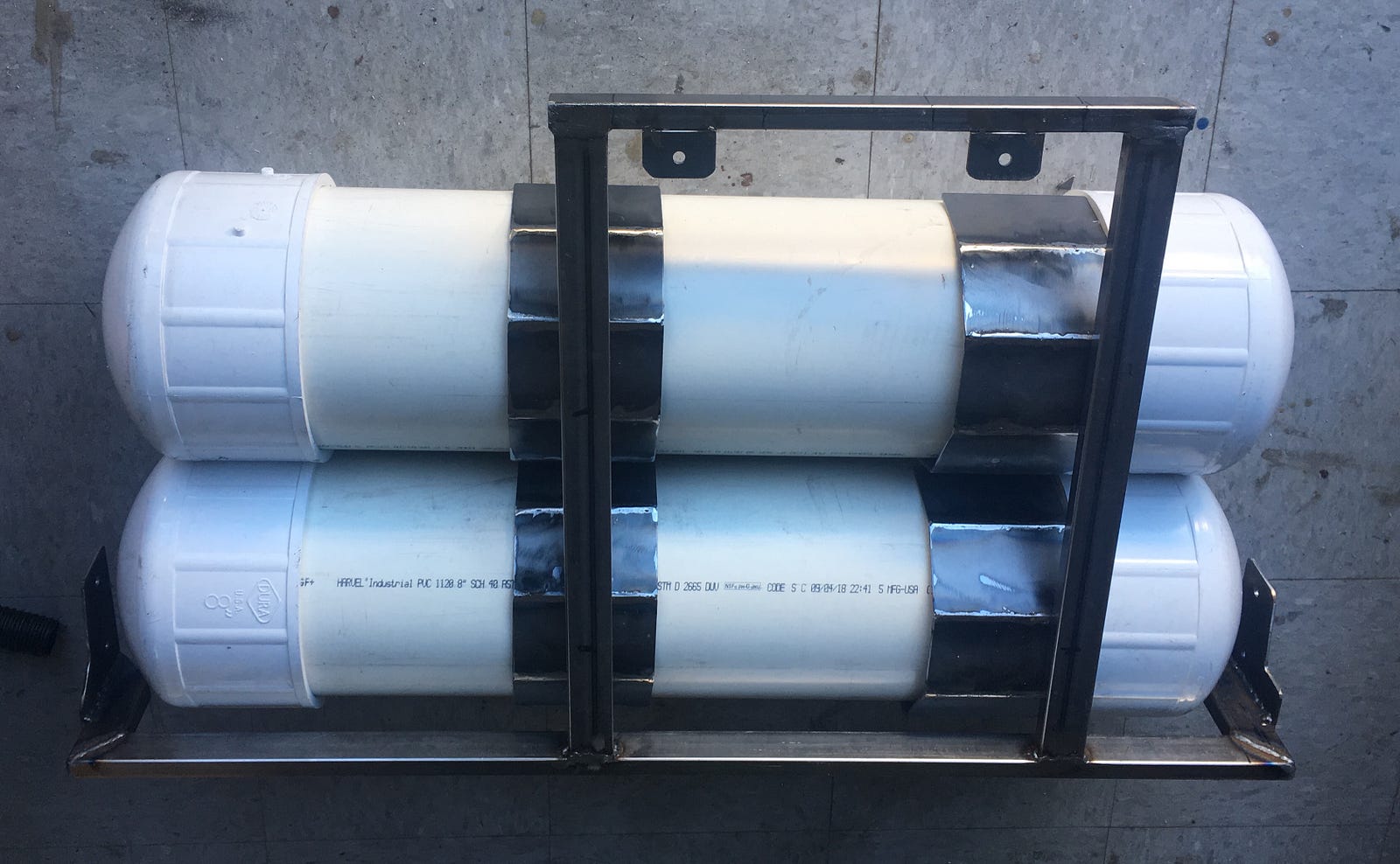

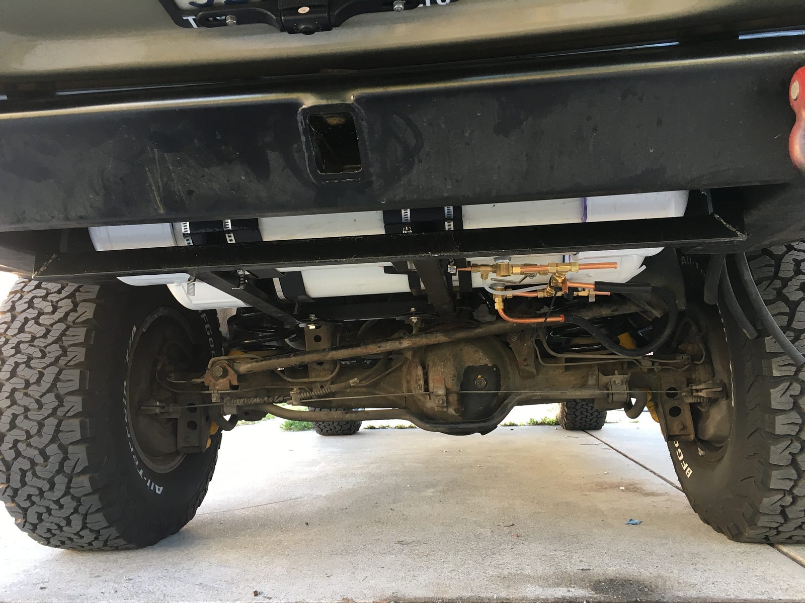

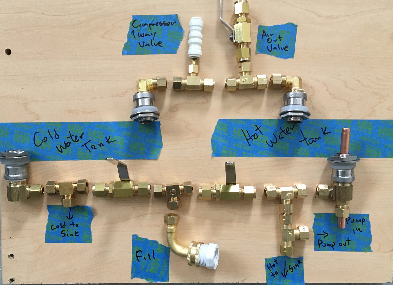

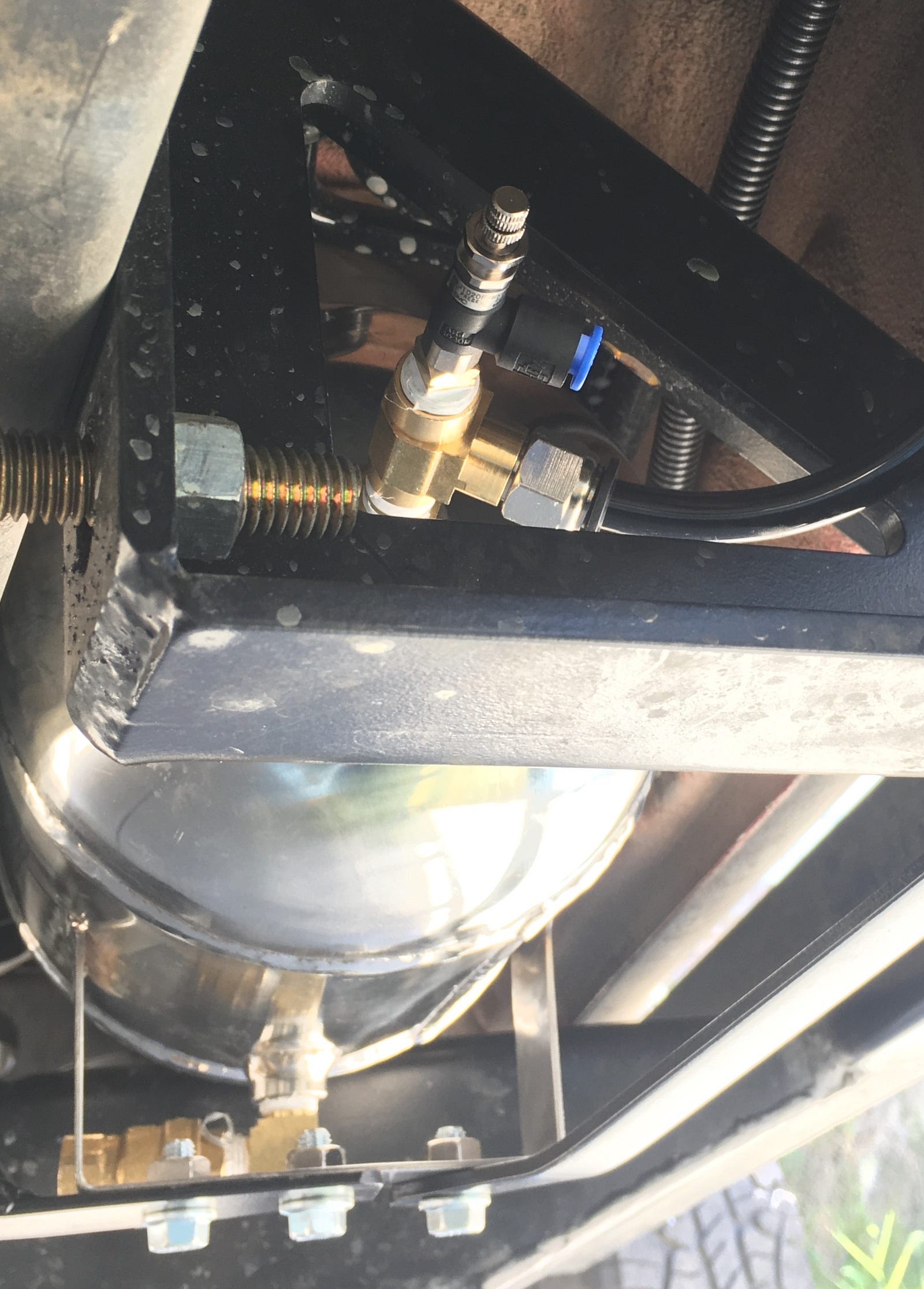

Tank will be vented. Since I’m not relying on air pressure it doesn’t have to be air tight. It’ll have an overflow vent up top.

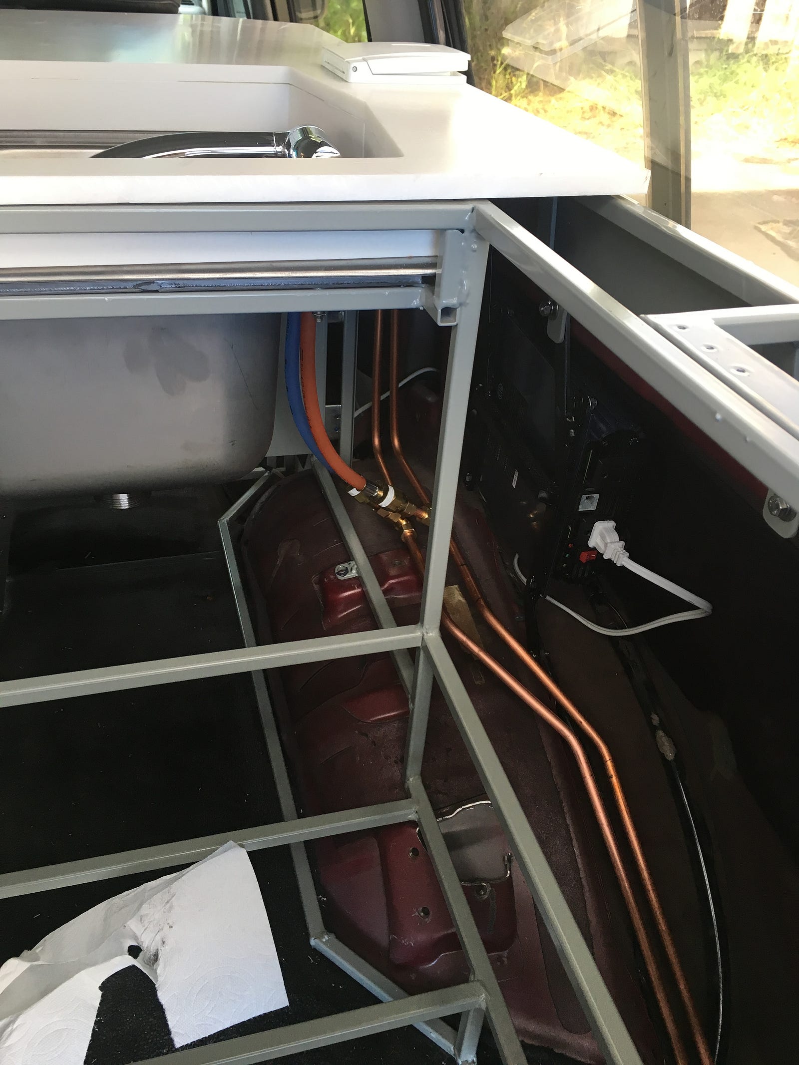

I’m building currently from the ground up a custom Landcruiser 75 troopy. Landcruiser 79 pickup suspension and axles including conversion to coils in the front, 80 series diesel drivetrain, AluCab popup roof and much more. I’m planning an Espar hydronic heater for cab and instant hot water so no need for dual water tanks.

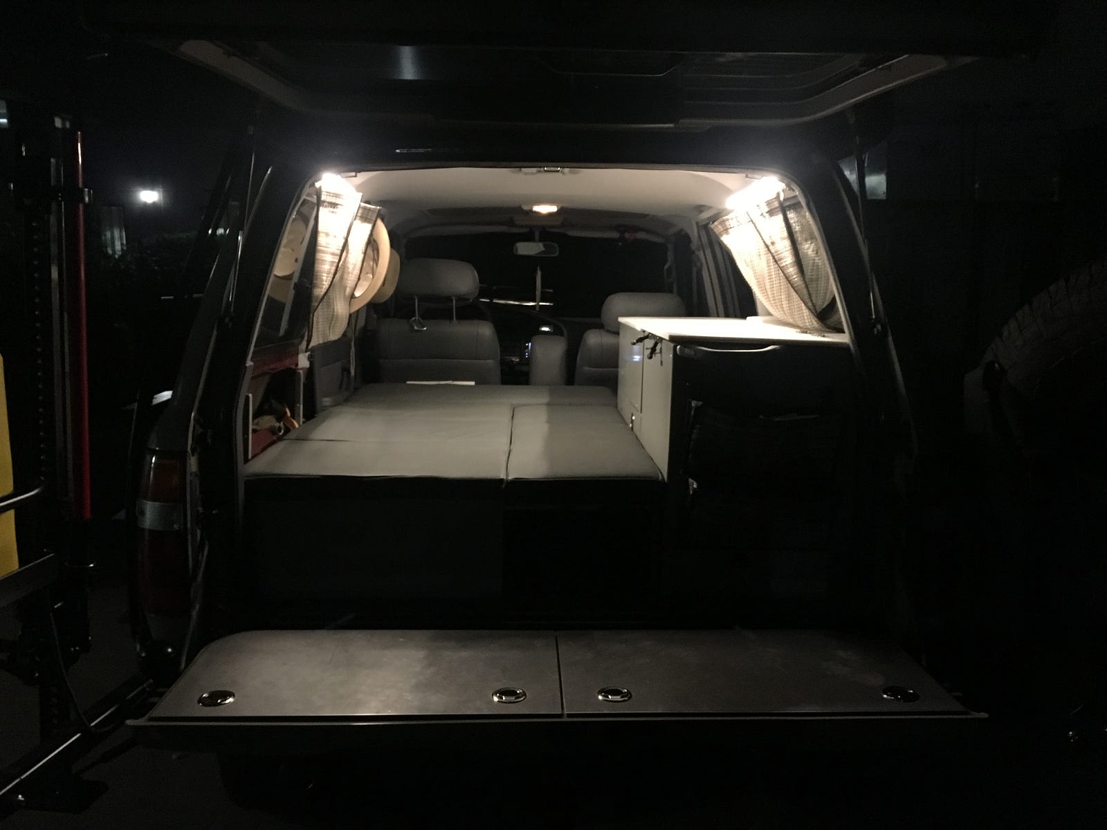

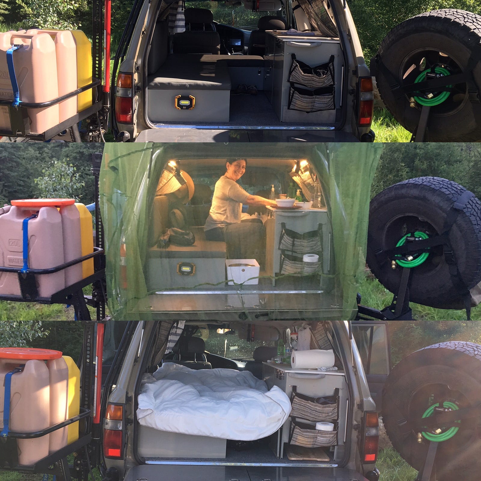

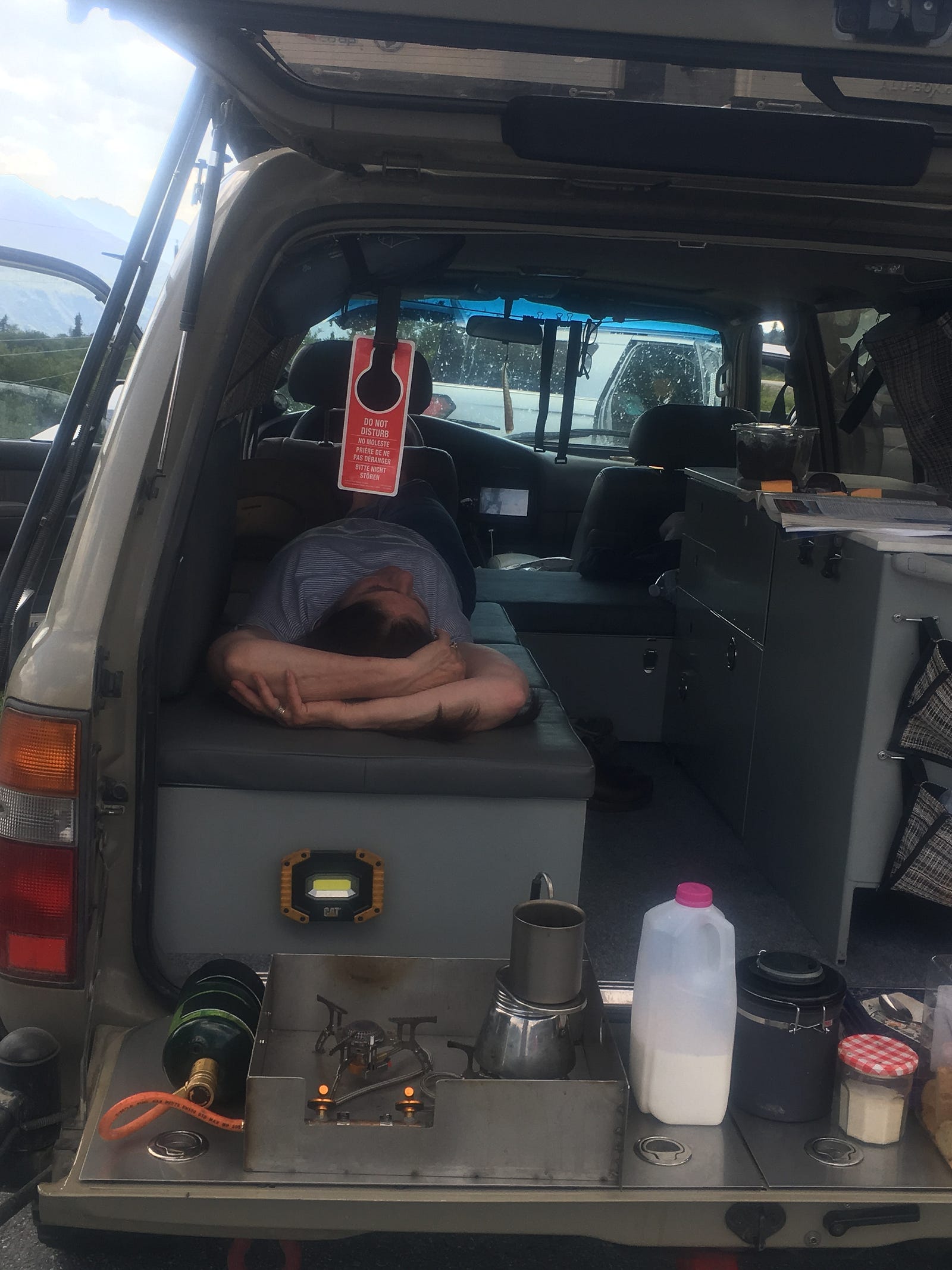

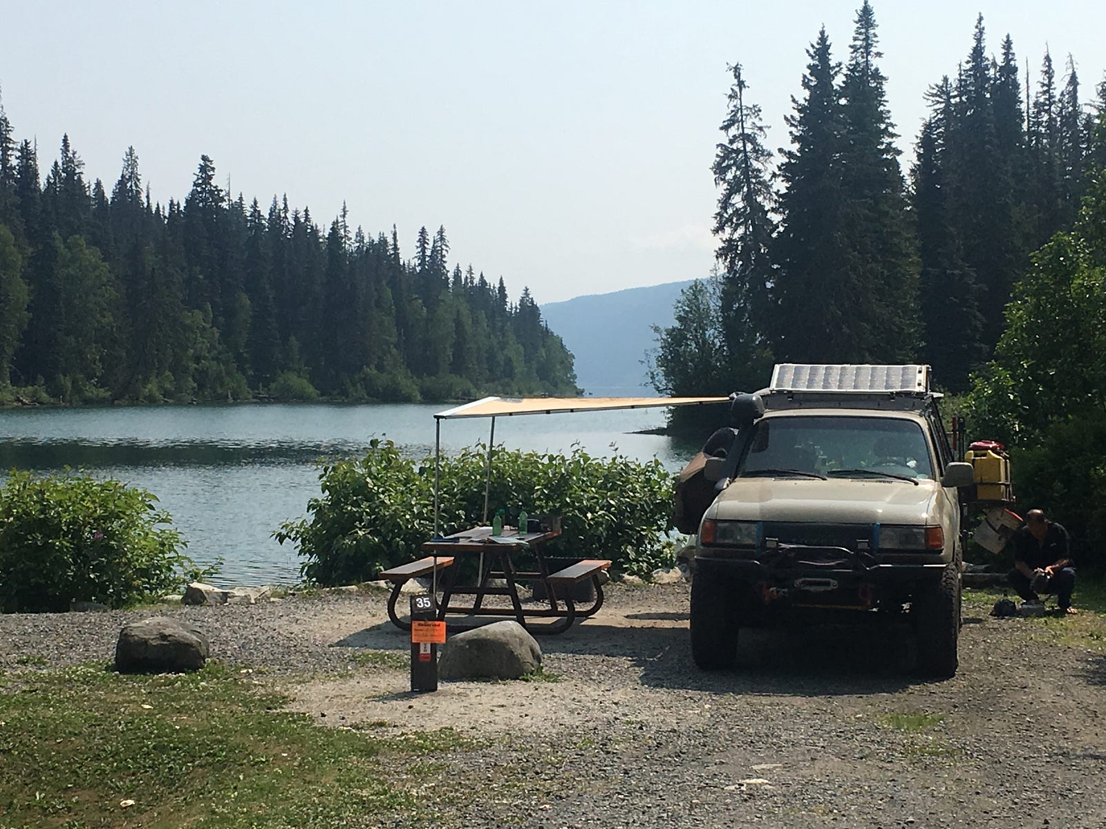

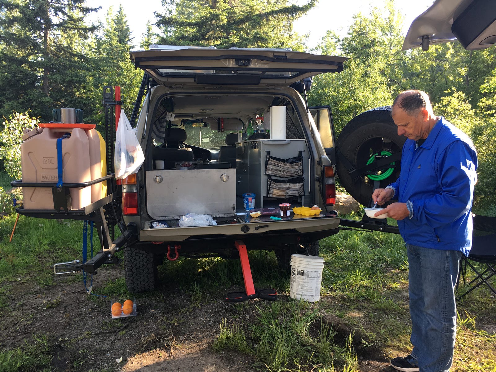

Just spent the weekend on the Cascades escaping the heat wave in CA. Every time we take it on a trip it reminds me how much I love driving this rig. We have full comfort of home. My wife looses the bags under the eyes because we sleep so well. It’s a state of mind as well as the air and nature around you.
Found an isolated lake, took a hot shower (air dry), dinner, enjoyed the full moon rise and went to bed.

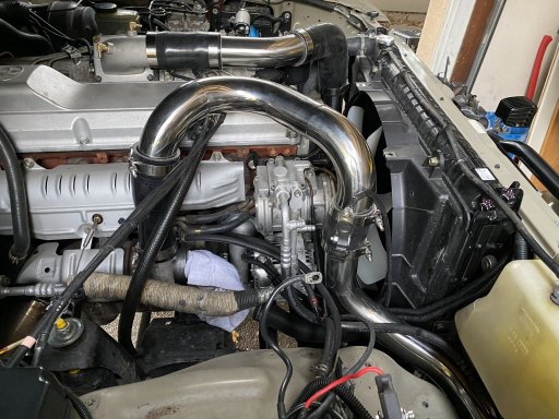

Just a small update. Clutch originally installed was a 275mm instead of a 300 mm intended for this engine. 275 is for the 1HZ no turbo. We ended up replacing the flywheel and installing a heavy duty clutch. This one burned when trying to pull a 10000lb sprinter van belongs to my brother up hill in lava sand. At this point, timing belt, water pump (70k miles) and rebuild rear diff (+300k miles).
All happened while my daughter was married. Driving to the altar in her 40 series landcruiser (Kermit). That rig is equipped with a 1HDT/H55 turbo intercooled diesel.

After installing a heavy duty clutch and driving it for 2500 miles, it shattered. I have seen this only in photos. I've been doing driving since 1973 and it is the first time I had to call a tow truck. There was nothing I could do. We don't know root cause, but the AUZ manufacturer claims misalignment, which is NOT true. While doing this I decided to refresh the H151 5 speed transmission. It probably has 400K miles on it and 3rd gear was popping out. It drives again, and shifts like new. The main bearings are much larger that I have seen anywhere else.

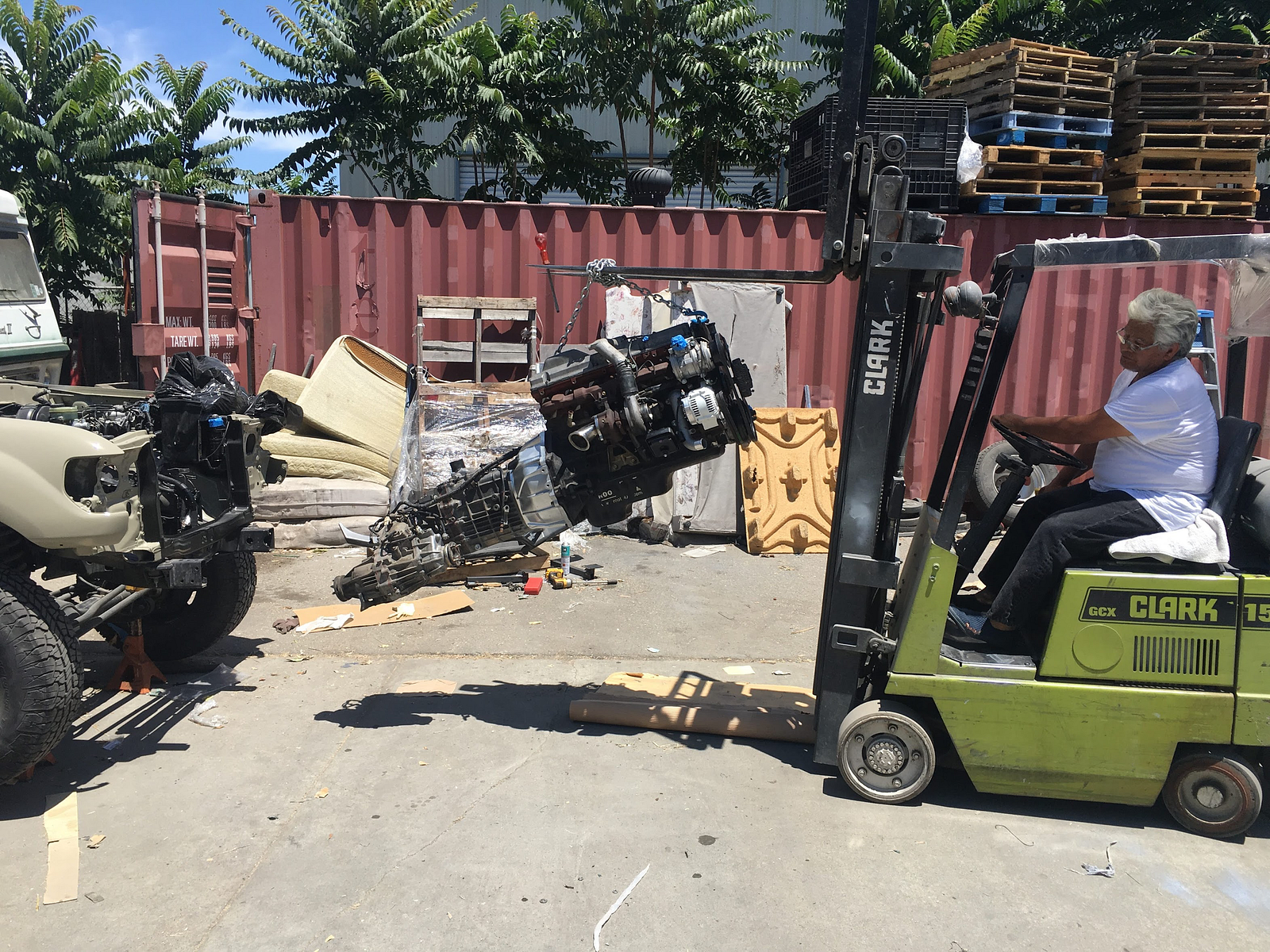

Meanwhile I swapped an engine in our daily driver, a 60 series landcruiser. Installed a 15BFT 16 valve 4.1L turbo diesel that came from a bus in Hong Kong. First trip up to the Sierras and back in a storm. It runs like a freight train. 26 mpg.
