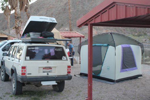

I still run a Yakima box. It has held up just fine over the years (and that is on the order of 10 years or so). Plenty of offroad time in there.
What you put up there does matter. For me it is sleeping bags, tent, mess kit, stove, fishing poles and a bunch of small stuff. All what I regard as light stuff. Food and water don't go up there. Not much up there in terms of tools either. Keep all the heavy stuff down low. And I keep it packed such that things don't have much room to move around. I have a couple of tarps and other flexible items that help to cushion things that would want to move.
I have a hitch receiver step that comes and goes as needed (and as practical for angle of departure).
