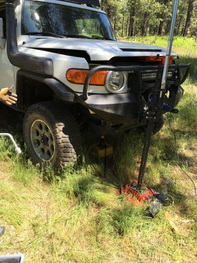

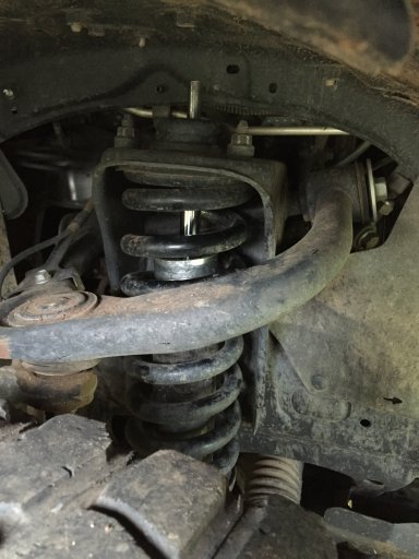

Replace a front coilover when the top of the shock that keeps the coil captured broke. It required multiple ratchet straps, a slightly large human in the form of @1Louder and some inginuity. Thankfully a friend only lived 30min away and had a complete assembly in his garage.

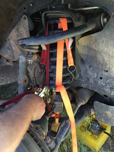

So we (myself and @1Louder) set up camp for the night and awaited on our friends arrival. Once he showed up we came up with a game plan to remove the broken components without disassembling the entire front end assemblies. Going to that much trouble would have changed the alignment, etc... So we compressed the coil as much as we could with a bottle jack under the lower control arm and @1Louder sitting on the truck. We used three ratchet straps and tightened them down. We released the bottle jack to relax the coil. We repeated the steps a couple of more times to take up all of the tension we could. Disconected the upper control arm from the knuckle and slowly lowered the lower control arm. We used a "Harbor Frieght" packing blanket as a ballistic shield over the shock assembly in case the straps let go. With a little jiggling and a small pry bar we were able to get the assembly out. Installed the new one and off we went for the rest of the weekend.

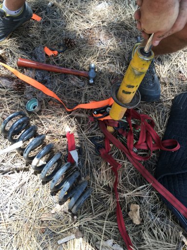

To release the compressed coil, we laid the assembly on the ground. Again covered the assembly with the packing blanket and with one person standing on each side ot the shock pinning it to the ground with the blanket, we cut the strap, or I should just say, we touched one of the three straps with a knife and the whole thing let go. All of the force was captured within the blanket so everyone was safe.

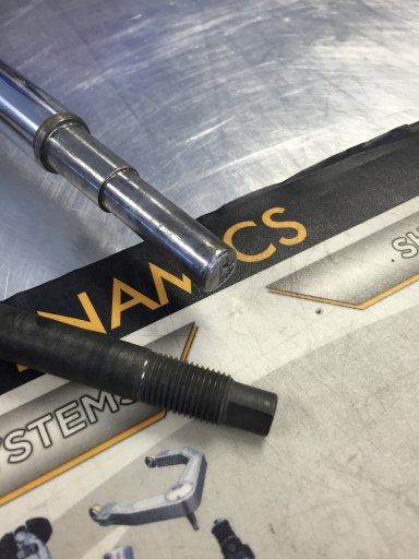

In talking with service rep from ARB, he mentioned he had never seen that type of failure in a shock ever (see last photo, you will notice that the threaded portion of the shock just sheared off compared to a newer shock).
