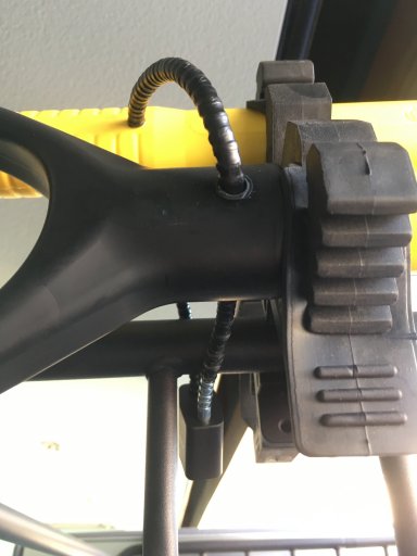

I use Fourtreks mounts with quickfists. Fourtreks only use a single tube so that's not an issue for your application. To secure my #murderspork and pulaski I presently use a gun lock that passes through holes in the handles and the rack itself.

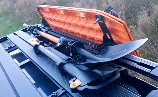

Lifestyle Prep 4.jpg I got so wrapped up into how I wanted it all to mount - it was almost maddening trying to find exactly what I wanted. I spent weeks looking for JUST THE RIGHT mounts for my axe and shovel and, in the end, ended up building up my own conglomeration of parts using one mount made specifically (but could easily be modified) for Rhino Pioneer platforms for the shovel and then Quick Fist mounts right next to it for the axe, so the shovel and axe almost nest.
SO, if there is ever a recommendation I make here on OB that I want you to really take to heart, it's this: Go Custom, Cobble Parts together! There generally isn't one specific thing that will make you 100% happy while carrying both. IMO.
