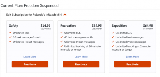

I've got the Garmin InReach as well for emergencies. I only activate the subscription a week or two before I know I am going on a trip, the suspend the subscription when I'm back and have not other trips planned...
How much does that run you?

I see and does that message regular cell phones? Or who do you message or SOS?
When you use the SOS it contact a global SOS first responder agency. I believe this coverage is like $25 year. If you want a plan where you get evacuated to the nearest hospital, then it's like an extra $129 year.
When you activate SOS on your inReach, there is a person on the other end who will communicate with you and coordinate with the proper responders in your location. They will stay in communication with you until your situation is resolved. (Note: This benefit is available to anyone using your inReach.)
For messages, yes it text a regular mobile cell phone. You can create fixed text message responses, which do not count towards your total for the month.
