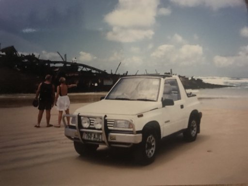

646
12 Grandview Drive, Redbank Plains Queensland, Australia
Will
Beaver
23460
I have been beach driving for over 30 years and never had a problem with rust. As long as you give it a good clean afterwards, high pressure hose into the chassis until the water runs clean, scrub everything underneath with a soft brush and running water and do this as soon as possible after coming off the sand. some precautions I take is give the bodywork a wax/polish just before going. While on the beach I avoid driving through the salt water and if I cannot avoid try not to splash through at speed, take it slow. If Camping I bring a spray lubricant like WD40 and give the suspension parts a bit every morning to minimise damage and wear from the sand, it is also useful for when salt water gets into your alternator the bearings can seize over night.
look after it and beach driving is less harmful to your rig than running through bogholes. and in my opinion much more fun.

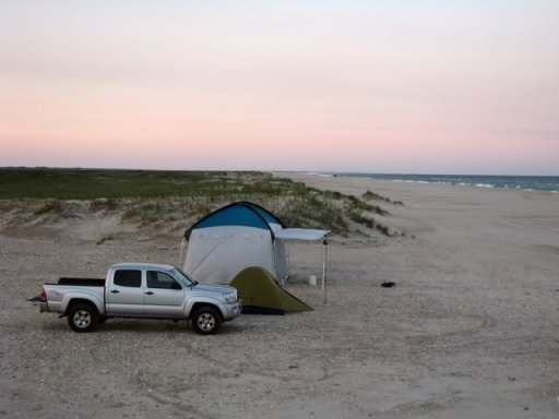

tarboro nc
Al
Killebrew
24080
