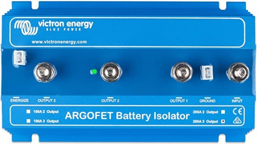

Thanks for the input. I've been heading in the same direction I think, except for the solenoid. I am setting this up now...
I have a 250 amp Alternator. The Output 1 is for the crank battery, output 2 is for the battery feeding overhead lights, trans cooler fan, radiator fan and winch. I am sending the port 3 to a pair of deep cycle batts in the back of the truck to run compressor, 4k inverter, misc. charging ports, refrigerator and the stereo amps.
So that was what I was asking about these type of auto isolators, vs what you're doing, or management systems. From what I read from Victron, the port 1 gets charged first, then port 2, then finally port 3. After that it's as needed to any ports for maintenance/demand.

I have run those in the past without issue. The nice thing about using power transistors is no moving parts and that one has three outputs. I'm going to give that a look. I stopped looking at the solid state isolators a long time ago due to the low specs. I haven't seen one with three outputs though at that power rating. It would be nice to separate my two vehicle batteries and my trailer battery.
