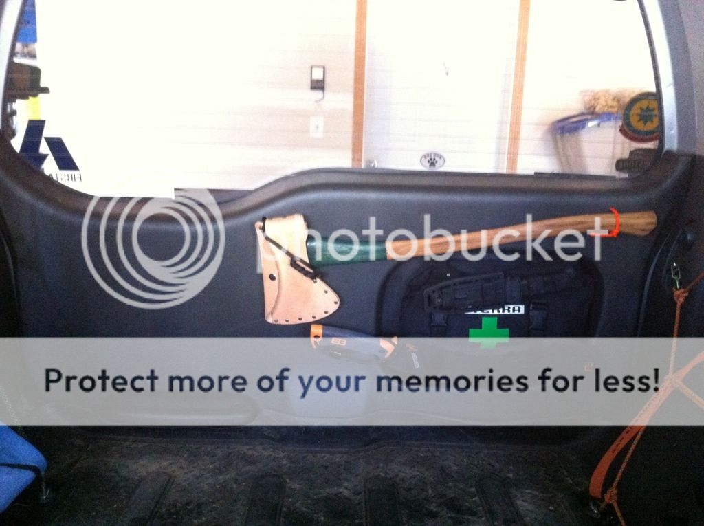

@txterra I just took everything out of my Xterra to sell it but I think I have a picture of it I just have to find it. What I did was drill 4 holes through the plastic trim, but I only had to drill 2 holes through the metal behind it. I mounted the head of the axe right behind the motor for the rear window wiper, the end of the handle went on the drivers side of the hatch. I just ran Nite Ize gear ties through the holes and around the bracket for the reader window wiper motor for support. I used a pretty thick gear tie for the head. The stock pneumatic rams that support the hatch had started to fail before I mounted the axe, so I replaced them with stronger models to support the weight I planned on adding. In addition to the axe I had a machete, a large fixed blade knife and a lot of additions to the stock first aid kit all mounted to the hatch. I'll find a picture and post it.
