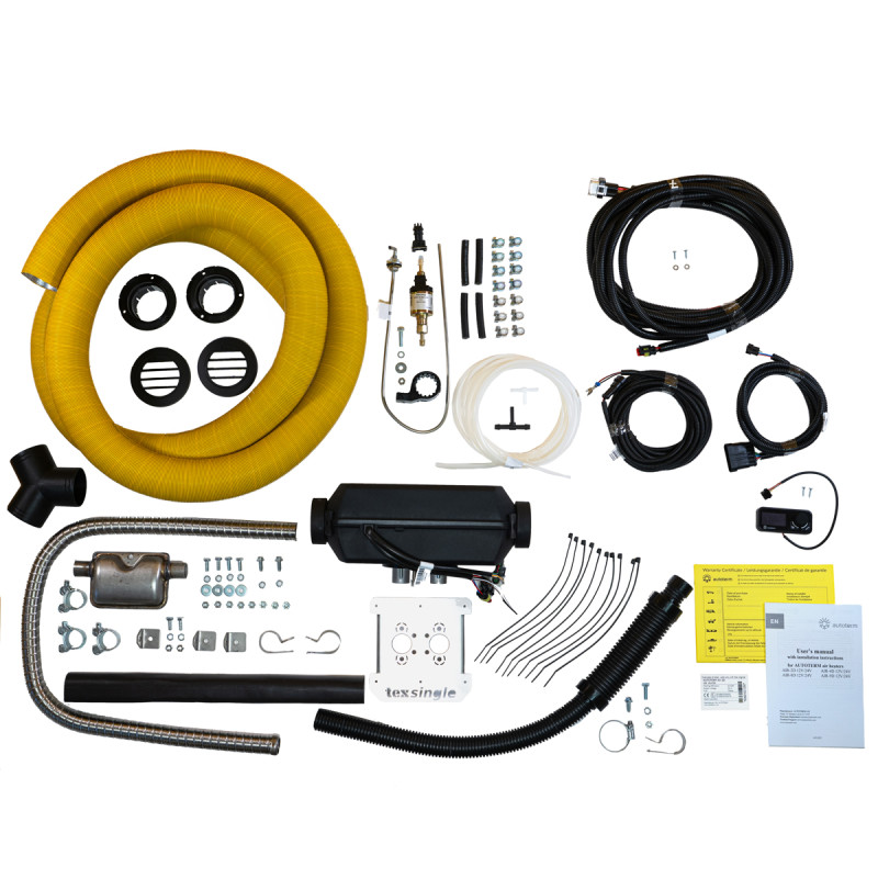

This is complete kit, exclusive the super silencers, there's just the standards included but it really isn't that loud and silencers can be retrofitted easily. This shop has a vast experience with heating solutions.
Another shop, Nakatanenga, sells a complete solution in a box but it's much more expensive but a fully standalone solution. The power consumption is very low, with a good battery its nothing to worry about.
Will add a link to the standalone heater below...

Well, there are a few manufacturers. Top dogs such as Eberspächer or Webasto, for example. Or the popular Autoterm products Mathias already mentioned which in the vanlife and overlander sector in Europe became more and more popular (due to its price). Or manufacturers such as Wallas, which are very well known in the boat sector. Webasto you get traditionally at the Bosch service, there I would ask then simply the next Bosch service at your place. Autoterm is distributed in Germany for example by tigerexped, there you can look in the online store for heating.
I have decided, for example, with regard to my diesel coolant heater for a Webasto. Because this is just a manufacturer that has been around for a long time with a lot of experience and good spare parts supply. In addition, I feel that there is a difference between the cheaper and more expensive heaters (I'm not even talking about the Chinese devices) in the value of, for example, control panel, housing, etc. to recognize. And I like to have high quality stuff because I would like to rely on it anytime.
I wouldn't worry so much about the power consumption. We are talking about warm air heaters in the range of 2KW power. After the increased start-up current, these usually have a continuous demand of a few watts in the upper single-digit range.
If you want to heat the tent, then of course the mobile versions of diesel heaters are interesting, which are more and more on the rise. There are either ready solutions to buy, for example in Germany here at Nakatanenga in different versions. And here in the forum you will also find many DIY solutions.
