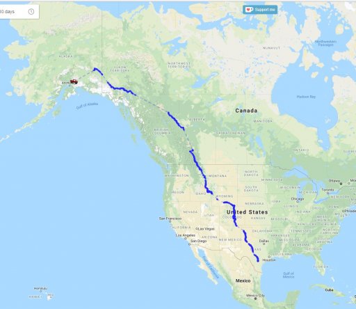

There is APRS.fi for Apple product users. I think it was $7. I am in Alaska and APRS digipeaters and igates are slim. Mainly in Anchorage/Mat-Su valley and Fairbanks areas. Canada is slim between population centers. Most of my local ham club members use it continuously. As I’m still working on setting up an APRS rig, I try to remember to run my app when I leave home. APRSIS has an app you can run in Windows that lets you basically report where it is to the APRS network. When I’m not gaming, I leave it running. At some point I plan to set up an igate at the house as well.
I think it depends on your equipment also. I saw a track of a guy that was running FTM400 from Arizona to Alaska. There where very few places that did not record a track or beacon. I have it on whenever I am in my expedition rig.
From what I have seen, it’s mostly the area you’re in. Places like SoCal have massive amateur radio infrastructure and many, many people using the systems. Here in Alaska, it’s mainly in the two large population centers of Anchorage and Fairbanks. APRS reports over 2m (VHF). There has to be an igate or digipeater for your radio to report to that uplinks your position to the APRS system. Those devices some ham has to buy, set up and keep operating. Many just don’t want to or can’t do this, causing areas with spotty coverage. The apps I mentioned earlier get around that by reporting directly to the system using the cellular data network. Because of the gaps and limitations to the 2m reporting, I keep the app as my primary right now until I get a radio set up to take over. I’ll still keep the app for when I am using a different vehicle or in areas without APRS coverage.
