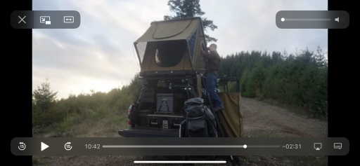

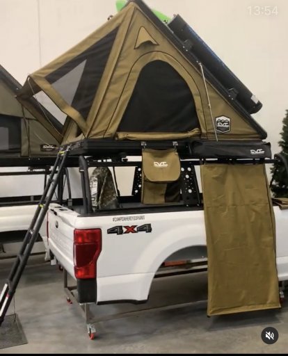

I own the Retrax Pro with Yakima Overhaul HD. I wish I didn’t bother. Should have gone with the leitner design with drawer system.
overhaul HD is supposed to handle 300lbs off road and 500lbs on road; however, mounted on retrax it is now 180 off and 300 on road... Things add up quick on weight.
CVTMt Hood dbl channel RTT: 216lbs
Shower awning = 25lbs
Short bed bars 9.46lbs
2 2gal RotopGas 3lbs
Rotopax Adapters 2lbs
= 285.5lbs
Roadshower 7g 77lbs (25lbs empty)
Yakima Recovey track Adapter 3.2lbs
Recovery Track = 15.5lbs
= 95.7lbs
Total weight = 383lbs
If you are planing to do this same setup, go with leitner designs and forget yakima/retrax or buy a trailer to tow and place tent on that.
if you still want this setup, I will even sell mine. Retrax pro, overhaul HD 68” with cross bars, eye bolts, and other attachments.

Had it on my old truck and loved it. Ran yakima HD bars, with yhe mid towers, 75" cross bars, smittybuilt RTT and rotopax water/gas cans. My favorite part of it was being able to walk on it setting up and tearing down the tent. I foudn that when i first had installed the cover with the bars that it wasnt tightened up enough and there was a small amount of play, i cod hear it squeek when driving. once I tightened up that went away.

I should also mention.
i have had 0 issues with the retrax cover. It rolls easily. Lock works great. No water leaks into bed other than at the tailgate but because I didnt add a seal there. It took a minute to figure out how to install it but wasn’t difficult. I used silicon at the hose lines to keep them from falling out. Sucks to lose 1ft of bed space but nice to keep stuff dry and safe.
